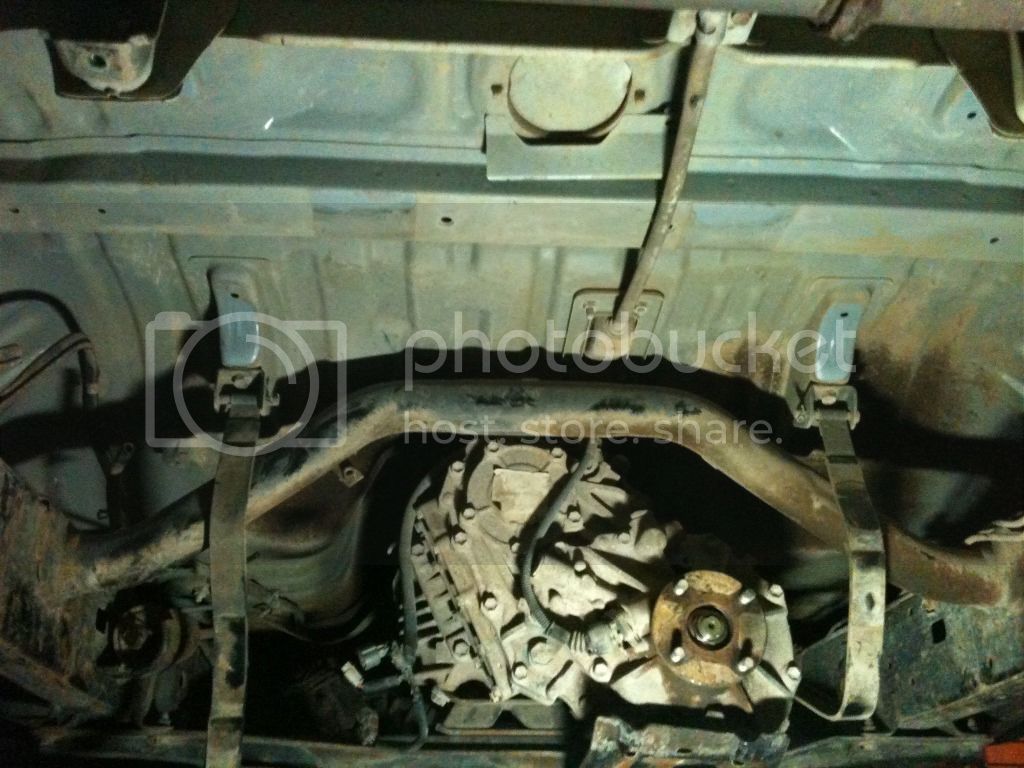

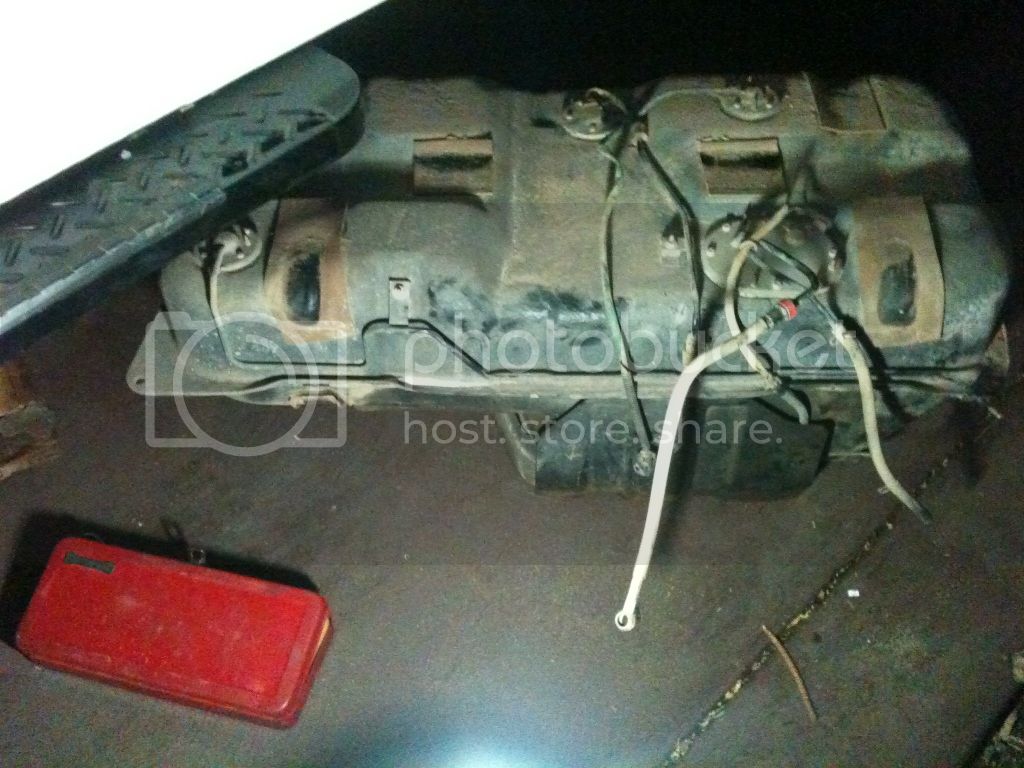

I removed my main tank out the other week to install a larger fuel pump,
I think there are 3small hoses to remove on the passengers side and 3 plugs i had two as i dont have a sub tank,the filler hose and its breather.
I didnt have the cruiser on a hoist when doing it so the angel on the tail shaft got in the way i did try but no luck so i had to remove the tail shaft by 8 tvery tight bolts,maybe on a hoist the rear tail shaft and diff would drop down enough to slide the tank over.
put a block of wood on a trolley jack and "take the weight of the tank" undo the two tank strap brackets and bend them right out the way( they will bend back to the tank shape no problems) then lower the trolley jack and the tank will come down.
The less fuel in the tank obviously the easier and lighter to handle

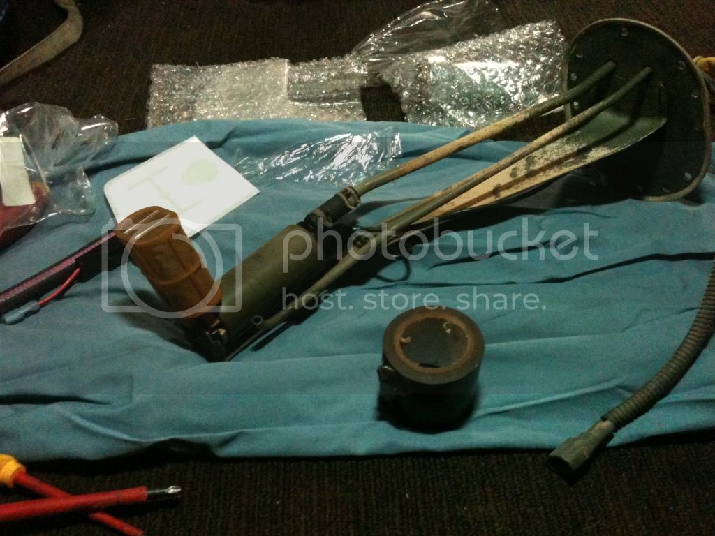

This is the fuel pump i pulled out , im not sure if diesels have a pump or just a filter on the end of the metal fuel line, but it will give you a idea of what to look for, this is out of the passengers side of the tank the drivers side of the tank has the fuel gauge sender
