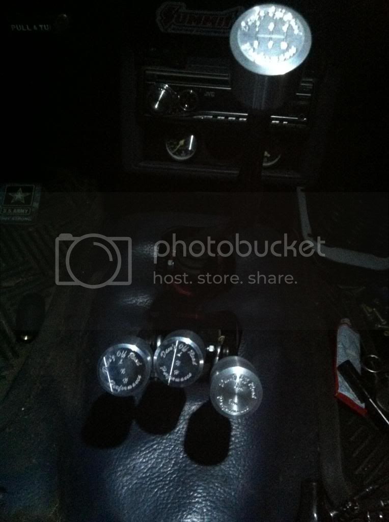

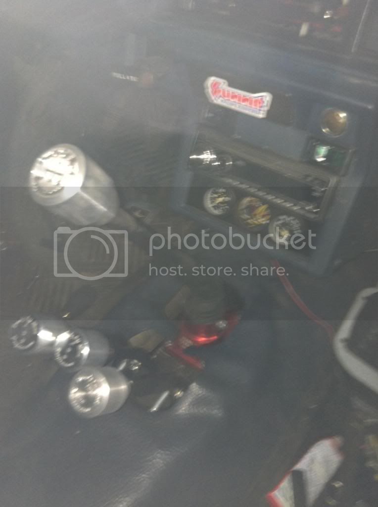

Just finishing installing my triple sticks,
Just need to squeeze the new boot in and bolt the down.
Triple stick: rad design FWD shift trans, FWD shift crawl bow, top shift rear , marlin short throw, davez off road knobs.
After playing around with these, im thinkin i should bend the outside sticks outward to make it easier to grab the shifter

So, if I am reading your post you have a FWD shift trans/crawl box and a top shift rear case, correct? And the RAD setup worked on that setup? Just want to make sure I am reading that correctly. That would be what i would like to do since my truck has a FWD shift setup stock.

Jynx, i had to modify his kit a little, i ordered longer linkage rods through a hardwar company off of midwest. then i cut and modifyed the base that the triple sticks mount to so that it could be bolted to the fwd shift crawl box. ( his kit is ment for two top shifts)
Davez off road says he has a triple set up for a (FWD/TOP) dual case, but needs a little tunnle mod.
