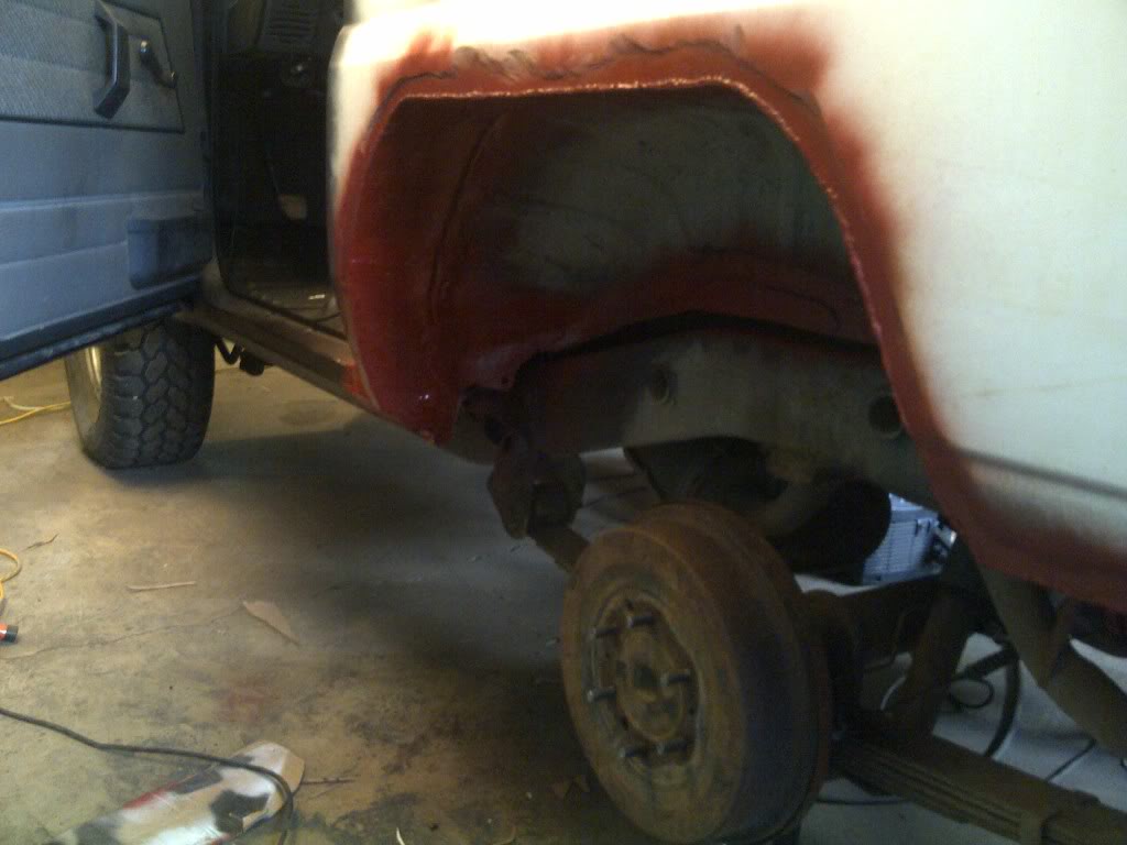

If you look at the cross section in the following photo you will get the idea.
I cut my rears out about 1.5-2 inches in places only due to heavy rust, beat the inside upper panels straight and welded the whole lip back together turned out better than expected. Had to split the inner fender in about 3 places and weld in new sheetmetal triangles to fill the gaps. Lotsa cutting and beating not for the faint of heart.

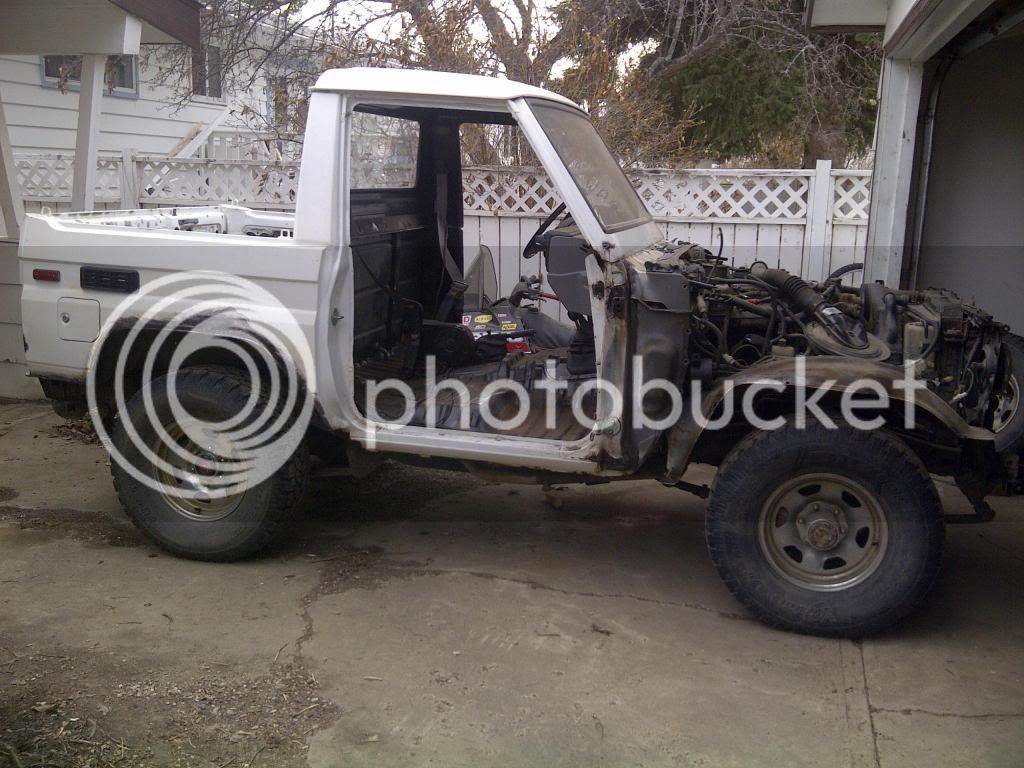

There's a mess of bondo on there, previous owner loved the stuff, there were some bad ripples In the sheetmetal after the top chop they must've dealt with that way. Hard to tell wish I had a better pic but they are noticabley larger.
