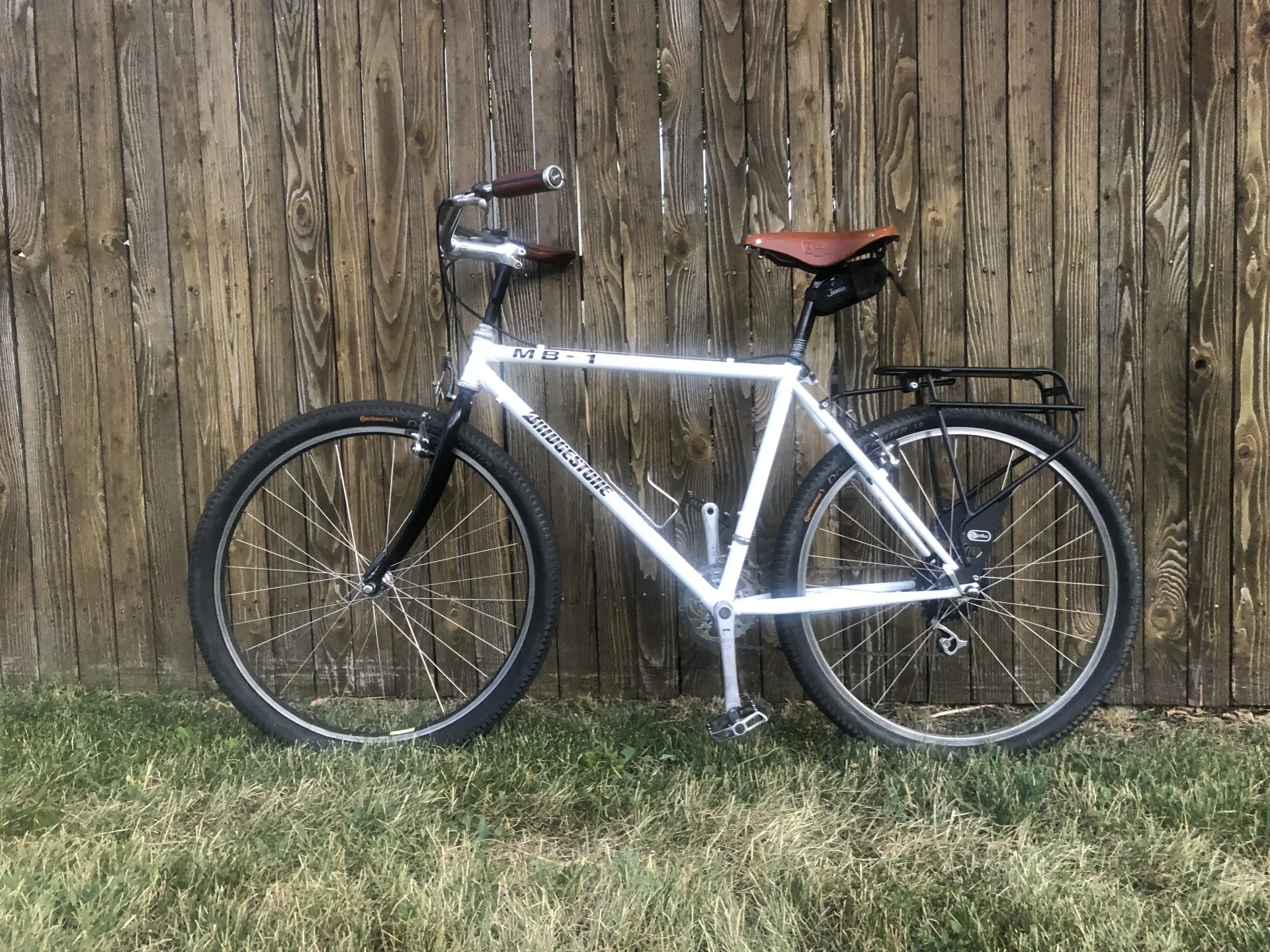

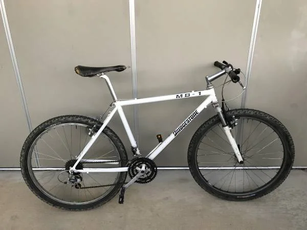

I did something similar with a Bridgestone MB-1. A suspension fork was swapped onto it when I bought it, but I put a rigid fork on it. 1 1/8 sounds familiar. It certainly can be done, and as luck would have it, I was surfing the forks on the Surly site earlier and I think they have what you need…
Before
After
