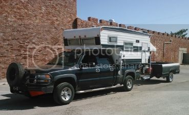

Probably part of an old post here somewhere... but, is any one familiar with the laws on transporting 55 gal drums of diesel for PRIVATE use in a truck bed trailer??
All I find on it is that it is OK as long as it is for private use and a limit on 119 gal. I only wish to haul 110 gal of diesel in two drums secured in a trailer. That will give my rig more than 1,300 miles of additional fuel supply for a range of more than 1,660 miles. To give an idea of the range that gives me, from my driveway it is, 1,338 miles to LA California, 1,326 miles to Mexico city, 1,427 miles to Puerto Vallarta, Mexico, 1,997 miles to Guatemala City, Guatemala and 1,760 miles to Quebec Canada. As the trailer will be dedicated to cargo the drums will be anchored down quite firmly so that is not a concern. Not that I would go any of those places but just for reference. YES, I know it would be best to have a commercially built transfer tank but I have several like new 55 gal drums on hand.

Well, it is the trailer I am already using to haul supplies, tools and two generators, about 50 gallons of water (+the 35 in the camper) behind my truck camper rig. About three times a year I travel with others in sort of a lose convoy going to events like Burning Man. I also personally do a bit of camping in out of the way places. My rig is already set up as a 110v power hub for my daughters C-20 camper van and others to pull power from when off grid. I do not plan on taking on the Rubicon or any thing like that. The set up will probably be just one drum and several 5gal gas cans for the generators and other travelers.
@ Mark W, I have been told by others that I should stand the drum up as it "sloshes" when on the side if not completely full. I like the idea of a hard mounted cradle set up!! Since you actualy have experence with this what is your take on that. Either way it will be held down with chains bolted through the floor and a bracket will be built around the bottom if it is upright. Thanks!
