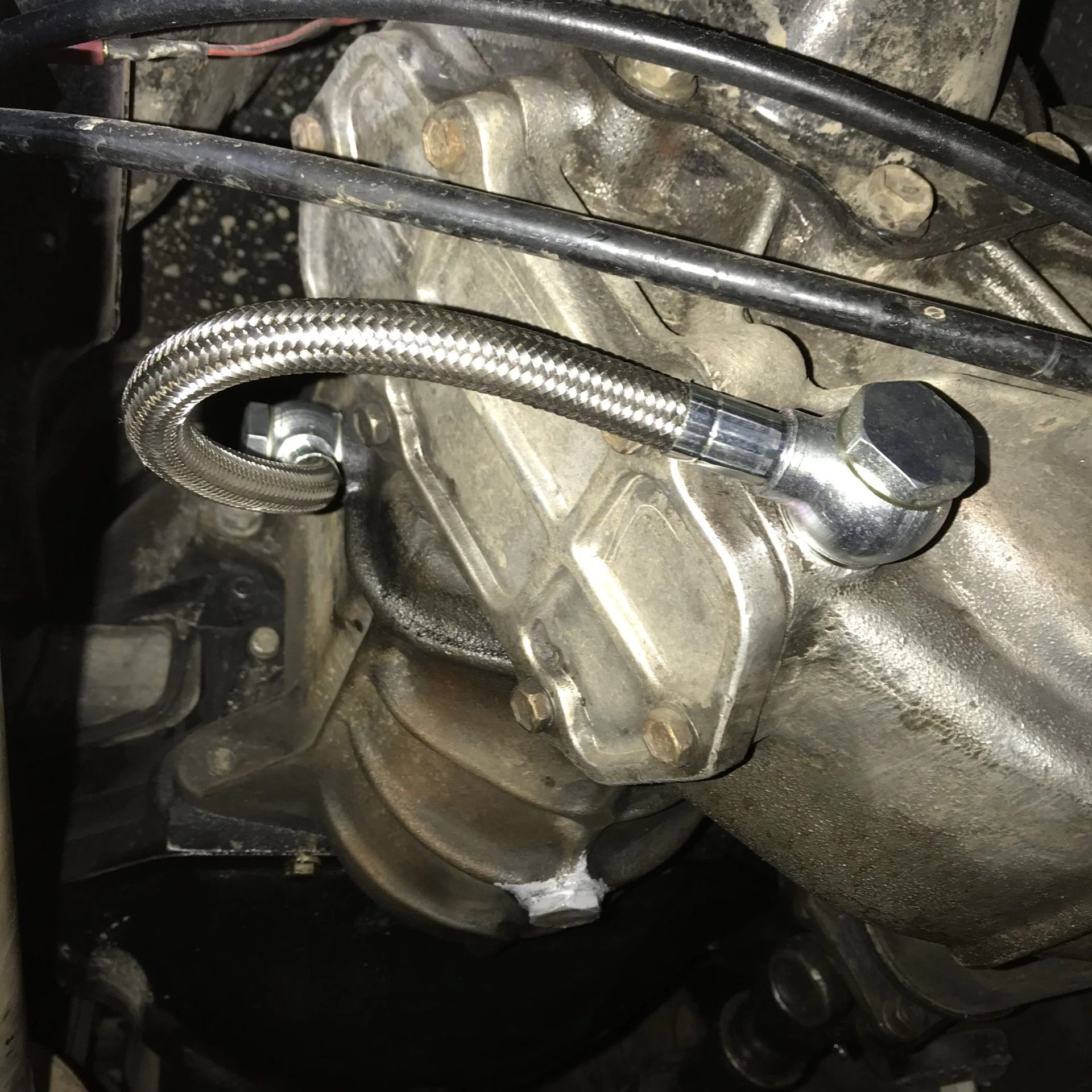

Here is my 12.75” hose installed on my ‘69 fj40 with the stock 3 speed. Perfect fit, thanks a ton!
