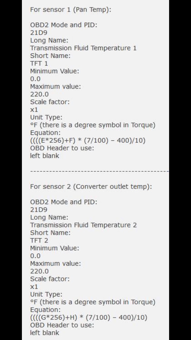

After a lot of searching and trying both 21d9 and 2182 PIDs I’m still struggling to get the transmission temp onto Torque Pro on my android head unit. I get temps in CarScanner, but would much rather have it with my other torque gauges. I’ve double checked the equations and consistently just get “no response” when testing. What am I missing? (It’s a 2008 if that matters)
