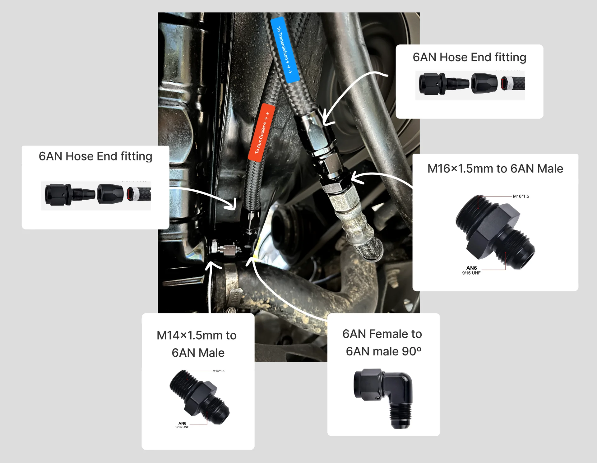

Reviving an old thread because I recently ran into the same challenge but hoping wiser minds can share their insights.
I installed a transmission cooler that had 6AN connectors instead of barbs so I found myself doing a partial conversion to 6AN fittings.
I wanted to avoid cutting the crimp on the soft line so I went with an adapter (per @Morgan Evan's post earlier #12). [M16x1.5mm to 6AN male] Tried to visualize my setup below. It almost feels too straightforward?
  1. What risks am I taking?
  2. Is the lack of an inverted flair on the M16x1.5 adapter an issue? (@Randy88FJ62 I saw your note about unobtanium special metric flares?)
  3. Am I missing or overlooking anything else?
Pretty sure you need inverted flare fitting at the line shown above. I've used psc fittings for power steering stuff for this they are steel not aluminum . If psc doesn't offer them it may have been borgeson not sure if I spelled that correctly . Hope that helps
Tommy
