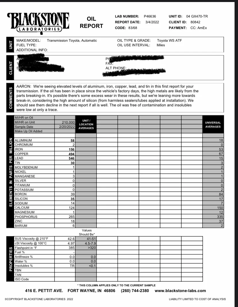

Just purchased a 2004 GX with about 200k, the analysis below was done on what I believe was the original transmission fluid. Blackstone mentions the high metal content is likely due to break in but you can see from previous analysis my numbers are more likely from not being changed for 200k.
Posting here to reinforce how metal content can get off the rails after 100k if the fluid is not changed. Also probably worth noting mine shifts perfectly (for now) if I’m driving it soft or hard.
It's interesting that the actual properties are good for both samples! I changed my OEM fluid at 135K and noticed no difference in shift quality, although the OEM fluid was pretty dark (and likely full of metals). Either way, a full exchange with MaxLife ATF costs <$100 as a DIY, so it's cheap insurance (IMO). I intend to change mine every 60K from here on out.
I think the manual states to it change out every 60k under severe duty (frequent off roading, towing, etc)…
Personally I’d do it regardless of how the vehicle is used… that lifetime crap is a bunch of bullsh!t
