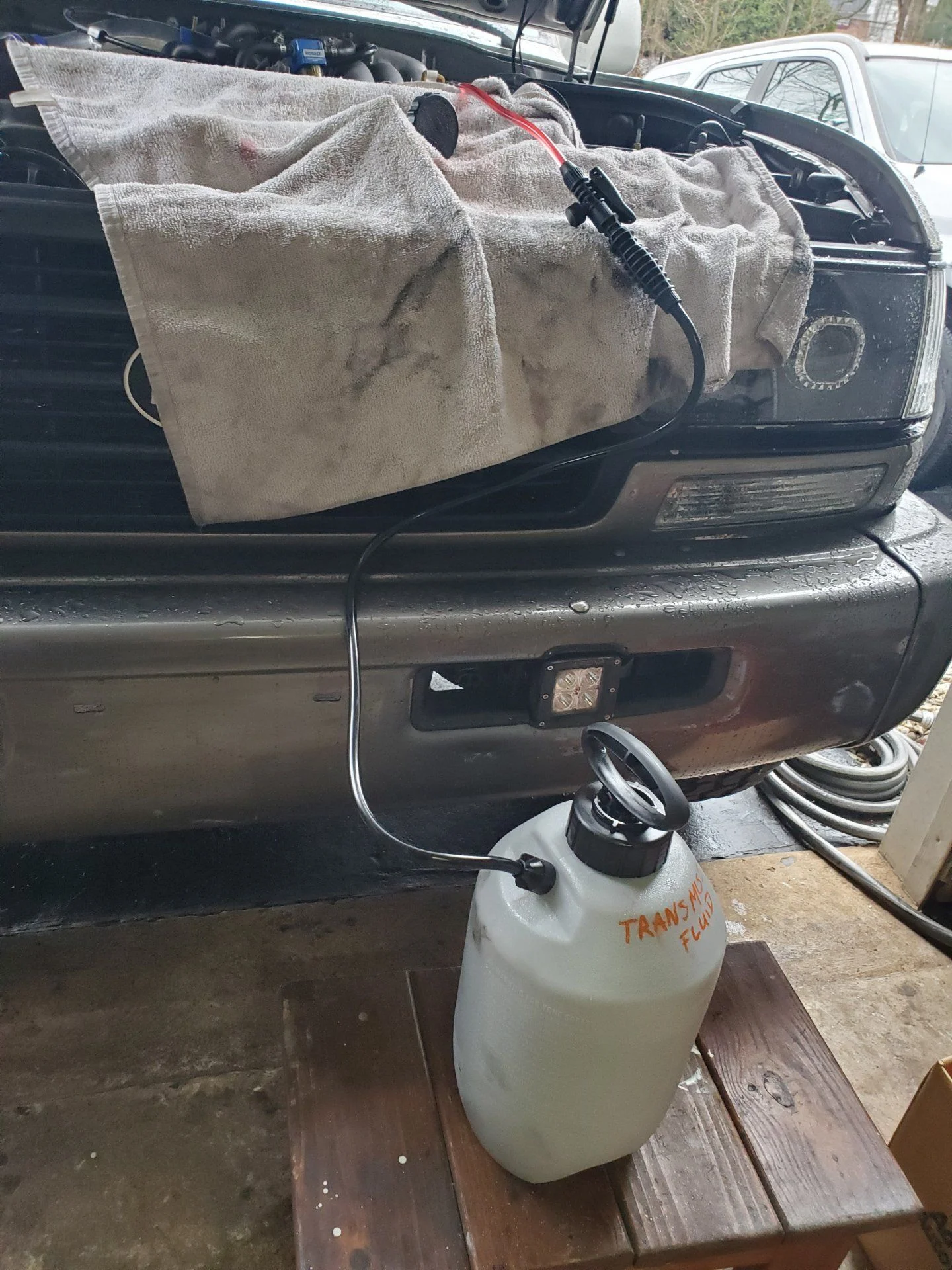

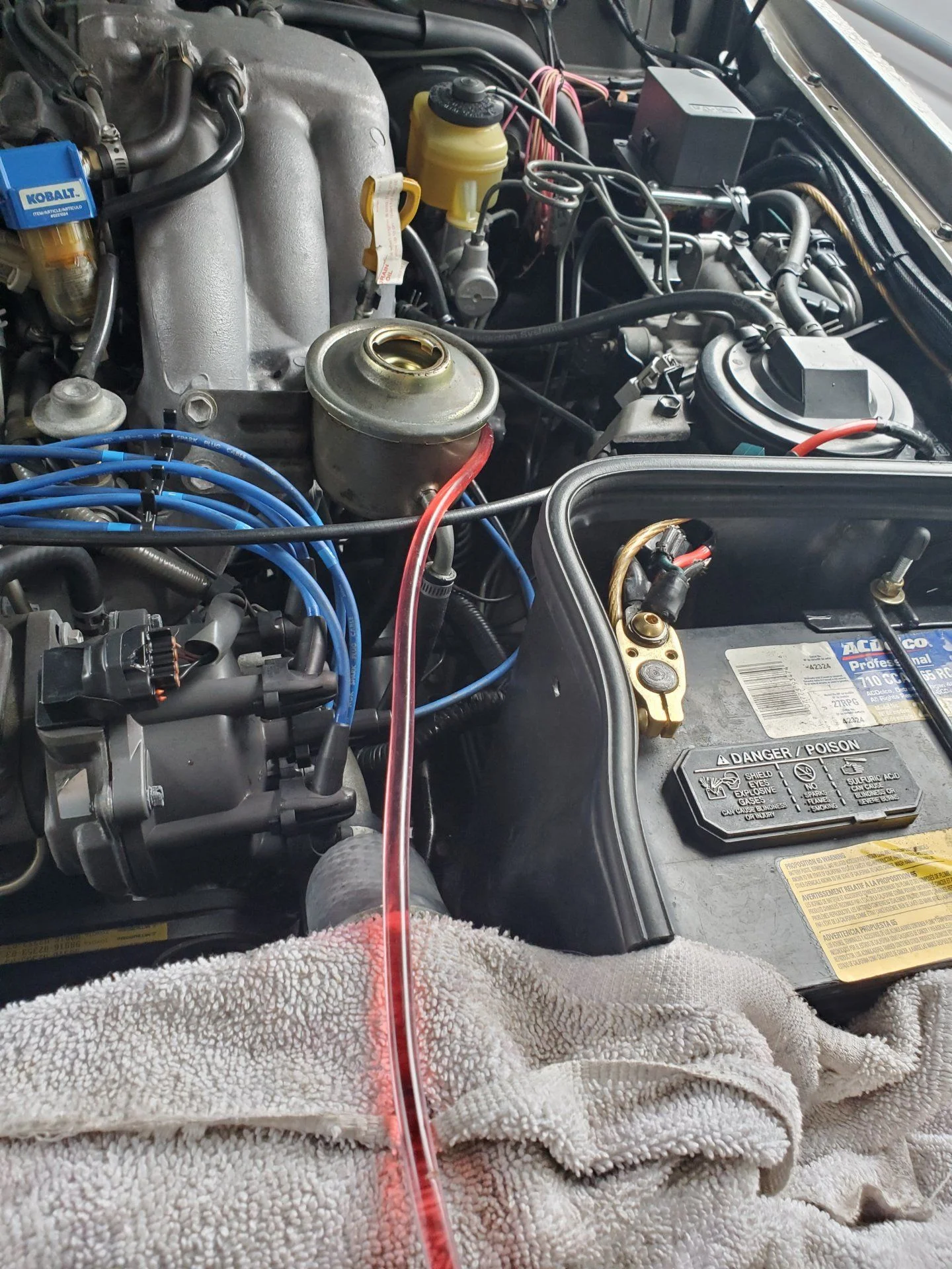

I was working on my wife's 5th generation 4runner and decided to do a transmission and differential fluid change since we purchased it used. I was search for and easier to fill the transmission fluid and diff. fluid. I used a $15 2 gallon garden sprayer and a roll of 3/10 ID 5/16 OD vinyl tubing and a 1 gallon sprayer for the diff. fluid.
if you do your own maintenance you have to try it out and it will make the job much easier than a hand pump. I ended up doing the 80 so here are some pictures of the sprayer.
What weight gear oil did you use in the gallon sprayer? 80w90
Nice! Sure beats being on your @$$ and hand pumping gear oil in which flows like honey!
The cold weather doesn't help either! 🥶
And the cool thing is that you can lock down the lever and it holds it open.
