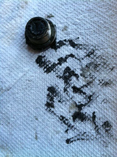

The tech forum has pointed at either a loose input shaft (or dead input shaft bearing), possibly a shot 3/4 shift fork/shifter ring mechanism, plain old worn gears, or something up in the clutch/pressure plate. When I drained the fluid from the t-case, there was definitely a large amount of metal dust (mostly very fine, but some were bigger chunks, smaller than a pin head but big enough to feel between your fingers). Unfortunately I have no idea when the fluid was last changed, so I have no idea if this is 30 years of metal dust, or a month's worth.
I think at this point, coupled with my T/O bearing chatter and jammed transfer case linkage, a transmission drop is pretty much inevitable.
My question: Given the metal dust (picture below) should I pretty much expect to just replace the transmission, or could this be salvageable? I want to minimize down time. Annoying part is I don't know how to further diagnose it without dropping it!

Hi @Freeborn - I hope your problem isn’t what mine had! It ended up being a sheared clutch gear in the transfer case. It was essentially grenaded inside - given the damage I was surprised it was still driveable at all.
Ultimately it ended up getting jammed in 4wd low so I had to pull the case. It got replaced with another used case I picked up. I ran that one until the 283 that came with my truck gave up. Rebuilt the second case with fresh bearings and am still running it today.
