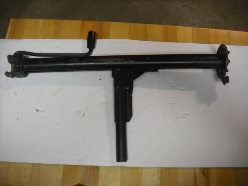

Wrecking yard crank jacks from a BMW are the easy and cheap way to go.
make a female receiver that the jack stub fits into and crank them level.
This will keep the trailer from dumping you or the bike when unloading.
Crank them up and remove for transit.
Fold the stub and store in the trailer.
