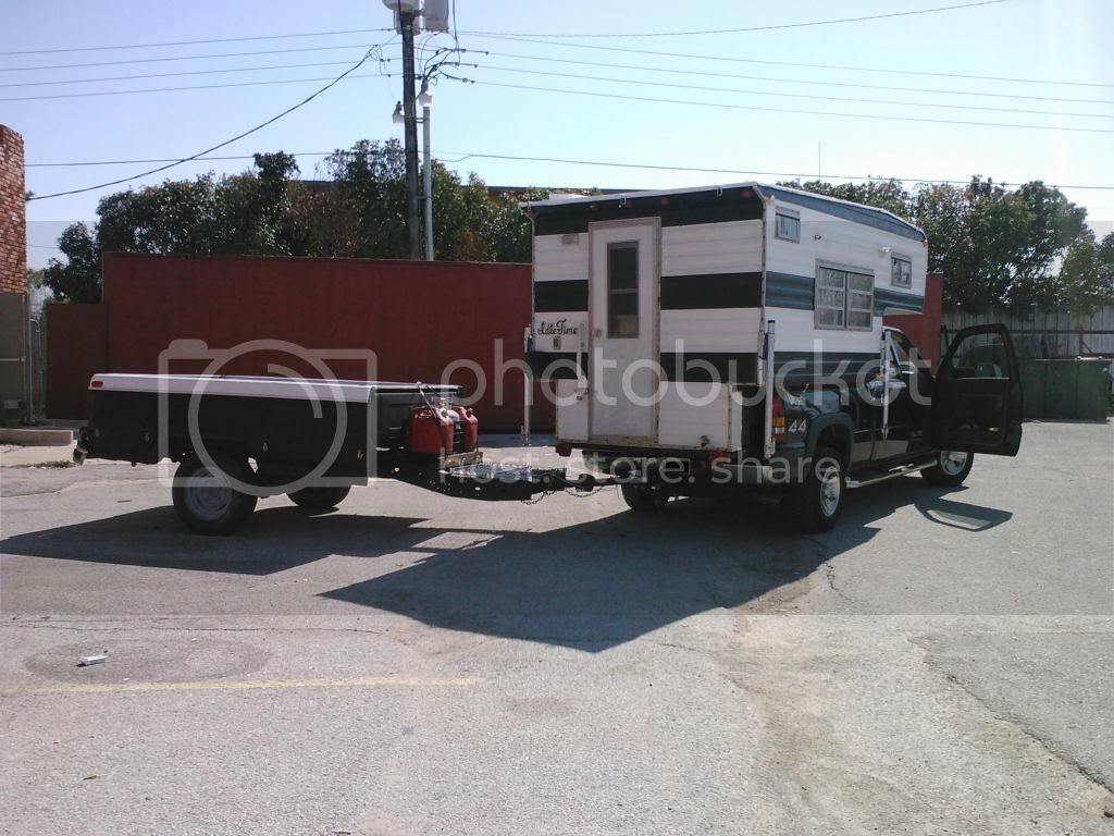

A friend and I built the trailer below and it doesn't bounce much unloaded and doesn't bounce at all when loaded. Another friend borrowed it and certified it stable to 85 MPH with just a quad and a dirt bike in it.

FWIW that green trailer has 3/4t leaves under it with no mods. We did fab mounts for shocks that we had that didn't fit the OE mounts. These shocks are stood straight up for best effectiveness.
