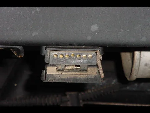

I haven't had much time to look into it except to stop by an auto parts store. They have nothing even close.It's an Ausi part.If I had the plug I could make an adaptor. It is a 7 pin plug but they are not in a circle they go straight across with the middle pin slightly higher than the others. I'll take a pic.

Here are some pic's of the connector.
That's a stick holding the cover open.:) MVC-005S.webp
I lied, never seen a seven pin like that before. You might be better off cutting that one off and rewiring it to a standard "US" 7-pin. They sell 7-pin plugs that have the 7-pin and 4-flat together in the same unit. Available at Tractor Supply and other stores that sell trailer wiring stuff.
