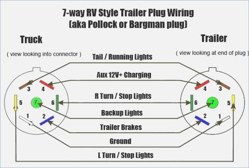

This is perfect! Thank you.

3 years later and Hopkins is still slanging these harnesses without clear install instructions??
This
Somehow I completely missed this when I ran into this about a month ago and thankfully my mechanic of a brother helped determine it was the harness and not the truck. He rewired the pin outs and saved my vacation. Unfortunate that there will be probably be others who run into this after us.
