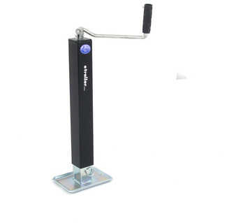

I need a new trailer jack for my flatbed trailer. The one that came with it does not rotate and I have drug it enough that I want to get it up and out of the way..
Is there any reason not to go with a square, 5K unit?
seems like for under $40.00 at surplus center the extra capacity would be really nice..

the thing is, I need the jack to swing out of the way. I cannot think of how I would do that mounted in the center of the tongue..

Shelby makes drop-leg jacks similar to the Bulldog's but in smaller sizes (down to 2500#'s) in top-wind and side-wind as well. The nice part about the drop-leg style jack is that you can have the foot of the jack almost flush with the bottom of the trailer and then be able to extend the drop-leg quite close to the ground and only have to spend 15 seconds to get the trailer lifted off of the ball rather than winding for minutes.
The downside to mounting a drop-leg jack that high up on the tongue is that if someone decides to drop the tailgate while the trailer is hitched up you may have some interference "issues", ie dents in your tailgate afterwards.
