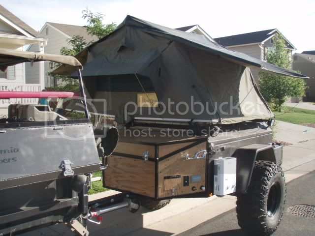

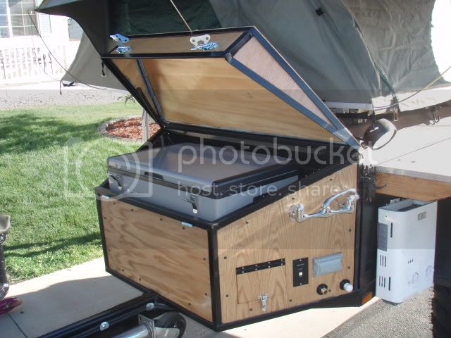

I built the box for the fridge to include the control panel, faucet, and 110 volt power.

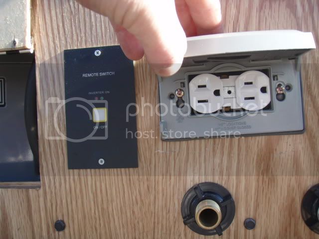

The inverter I got has a nifty little remote panel that turns it on, which is a good thing because you can't access the inverter when the tent is set up.

I'm concidering mounting the water heater here perminantly. As it sits now I store it in the back and hang it where you see it now. It connects to the plumbing you see at the bottom right hand side of the box. Wha-la.. hot and cold water!

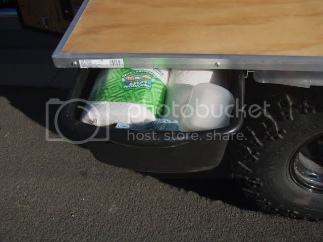

I stored all the cooking/cleaning supplies under the table.

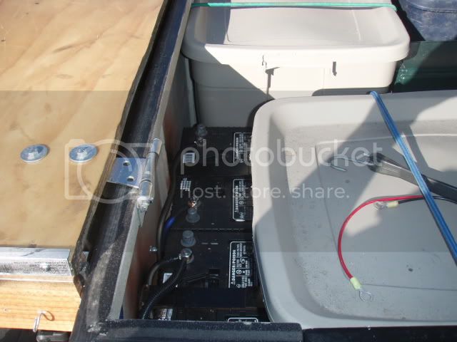

I moved the batteries to the rear of the trailer to reduce the tong weight..
To charge the batteries or assist with winching I ran 4 gage wire through one of these what-cha-m-call-it plugs.

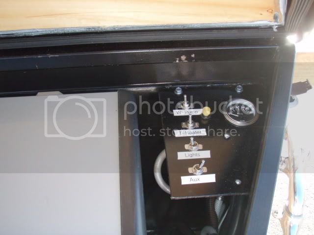

Pic of the control panel.

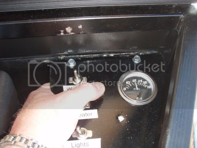

Push the yellow button to read the battery voltage through a back lit meter.

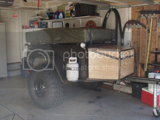

I moved the propane to the side.
