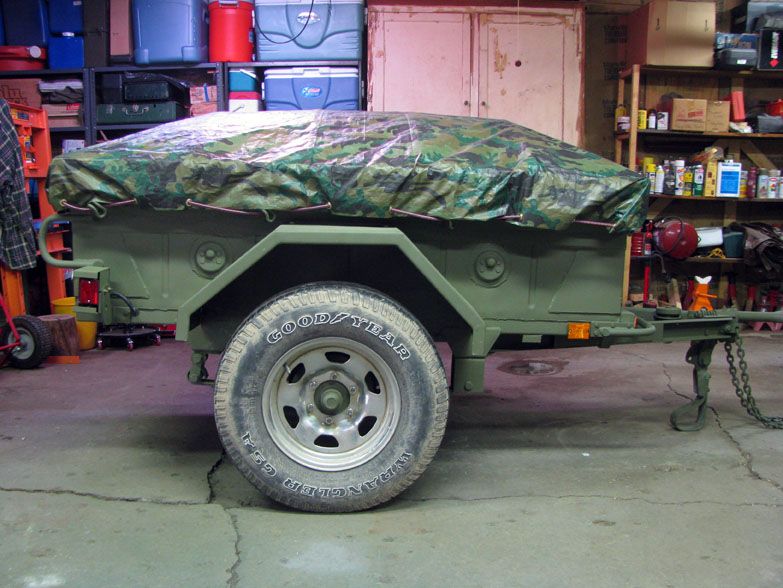

Ground clearance for up to 33" tires can be easily provided with a standard leaf spring set-up with no rise and the axle OVER the leaf springs. That's how most 1/4 ton trailers are set-up. If you need a little more clearance, just mount the springs over the axle (SOA), but 33s should fit without the need for that with proper design. An example is our 1/4 ton M101 CDN, where you can get an idea of how this relates from this pic.
While on some short tires here, with the custom fenders I had made it clears 33s with no problem. You can see by the spring hangers how it fits and that the springs are still under the axle like this.
While on some short tires here, with the custom fenders I had made it clears 33s with no problem. You can see by the spring hangers how it fits and that the springs are still under the axle like this.[/QUOTE

Yeah, you would need the SOA to run 35s. They would definitely rub the underside of the fenders without an SOA configured as my trailer is and I suspect very similar with other military pattern 1/4 ton trailers. But really, you're only a couple of sets of U-bolts away from an SOA by building it SUA and running 33s until then.
Some trailer axles are dropped. If the trailer that you're looking at uses one of those you can gain a lot just by going to a straight axle. The better built trailer axles will have some camber in them, so merely flipping those over isn't a good idea.
Yeah, flipping the axle has its own share of issues in any case. Better to move/reweld the spring perches and leave the axle in the same position, just dropping it to be under the axle.
