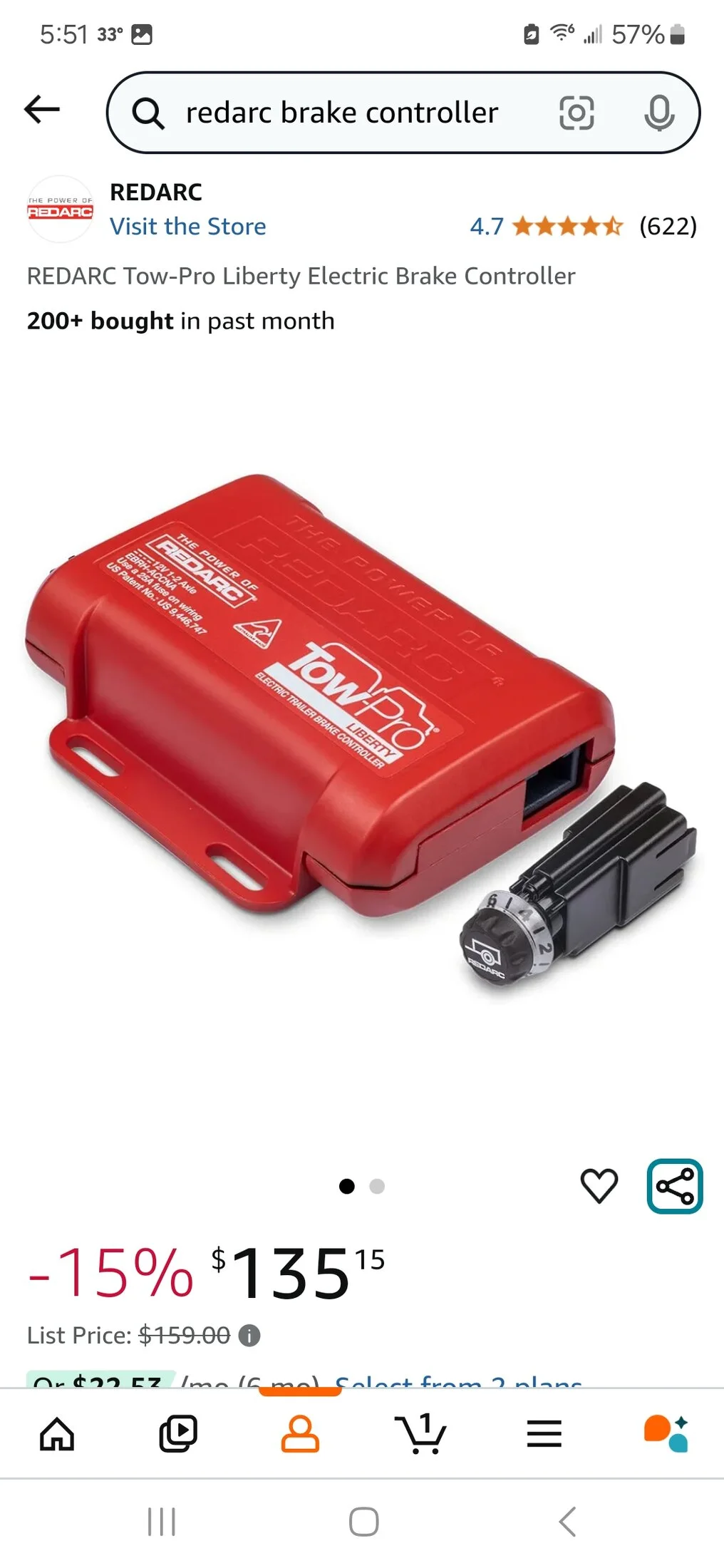

What hj60 said. There are brake controllers that use accelerometer chips to modulate the electric brakes on the trailer, assuming that’s what you have. They work great and greatly reduce the complexity.
Echo Bluetooth Trailer brake controller.
CURT Electric Trailer Brake Controller
https://www.amazon.com/dp/B07JQ99SDD?tag=ihco-20
I love mine, and you can move it to different vehicles. No splicing wires or equipment in the cab. Control the settings from the App on your phone. App does not need to be active all of the time for it to work. Once you have dialed in your settings to accomodate the trailer you are good to go. Set it and forget it.
