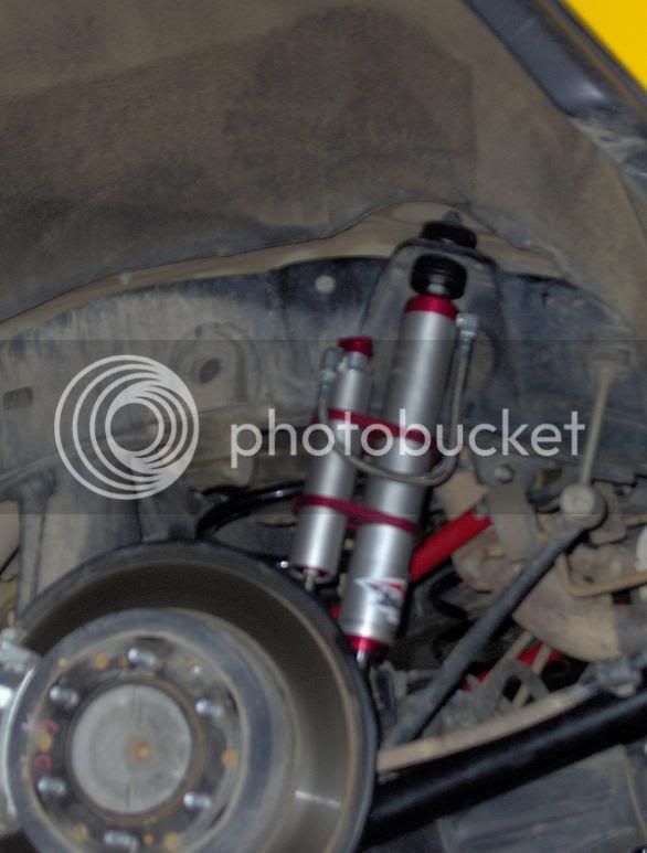

front coilovers
Rear shocks

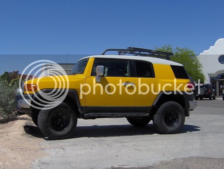

Here you go, I'm on a slight incline so it makes the front look higher it's perfectly level!!!!

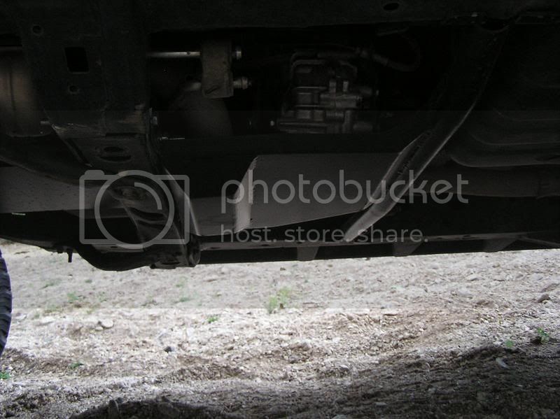

Tranfer case skid!!!! perfect

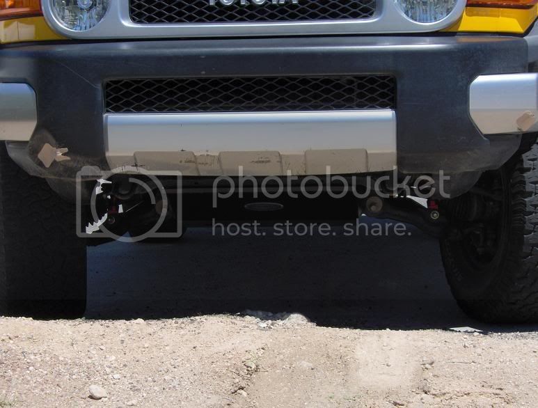

front skid too bright in tucson right now, I will post more when it's getting darker.
Skid plates

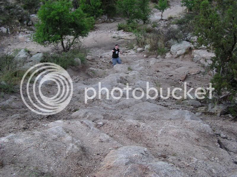

This is a view from up top of one of the last obstacles the rock @ the bottom is 2 1/2 feet tall WOW I'm loading up video of the ascent of this hill

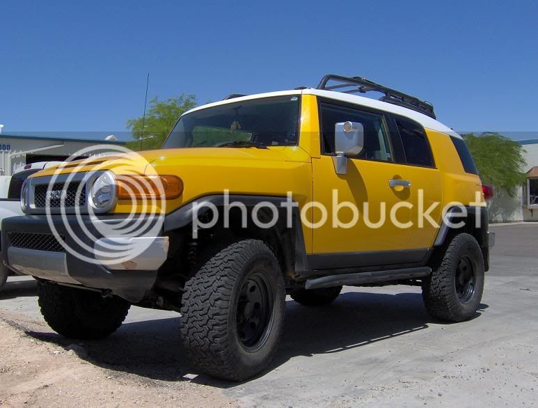

HERE ARE ALL THE MODS SOO FAR
All Pro adj coilovers (front and rear)
rear & top links
UCA's
skids front trasmission and transfer case
reardiff lock/atrac hack (alex mod)
285/75/16 BFG AT's
16 black steelie rock crawler wheels
front body mount chop
rearlink custom housing (supped up w/ 3/16" steelover oem 1/8")
rearlink custom skid
Demello rock rails:)
So I hope this helps people figure out what to do:)

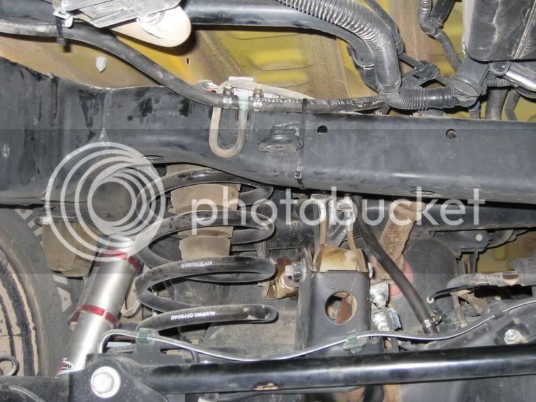

:doh: Yeah the resevoir lines have been fine, no contact what so ever. We figured that was the lowest point of the UCA where as the other side is high. I have been hitting some whoopty doos too.... I've gone over the vehicle many times and everything looks good.....now heheheh....I see what you are saying it will create a loop that tucks within the uca... thanks for the heads up....I will swich them:) hehehe.. i will edit the pics later so no one is confused:)
Mjager going to check those pics right now:)
My buddy who installed the kit, had reversed the reservoirs since these pics have been taken, so I had them in the correct spot the entire time except for the rough fit, which is pictured above. That's why I have had not issues bwaahhhahahhaha:lol: !!!!!!! I will update the pics soon:) Thanks again

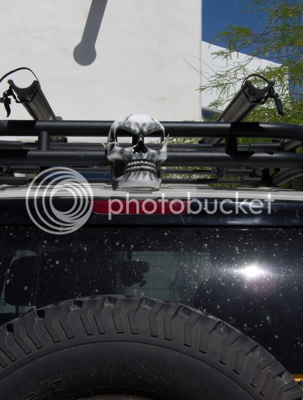

And some new skulls for my Cb antenna!! Its a radio shack cheapy but works awesome!
