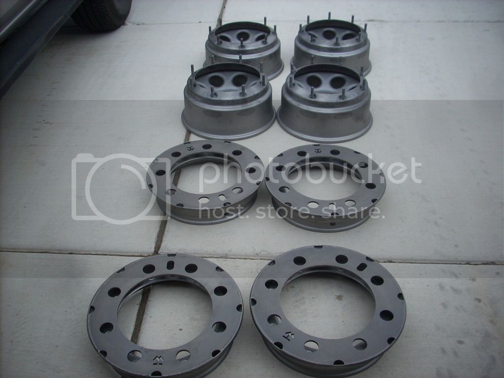

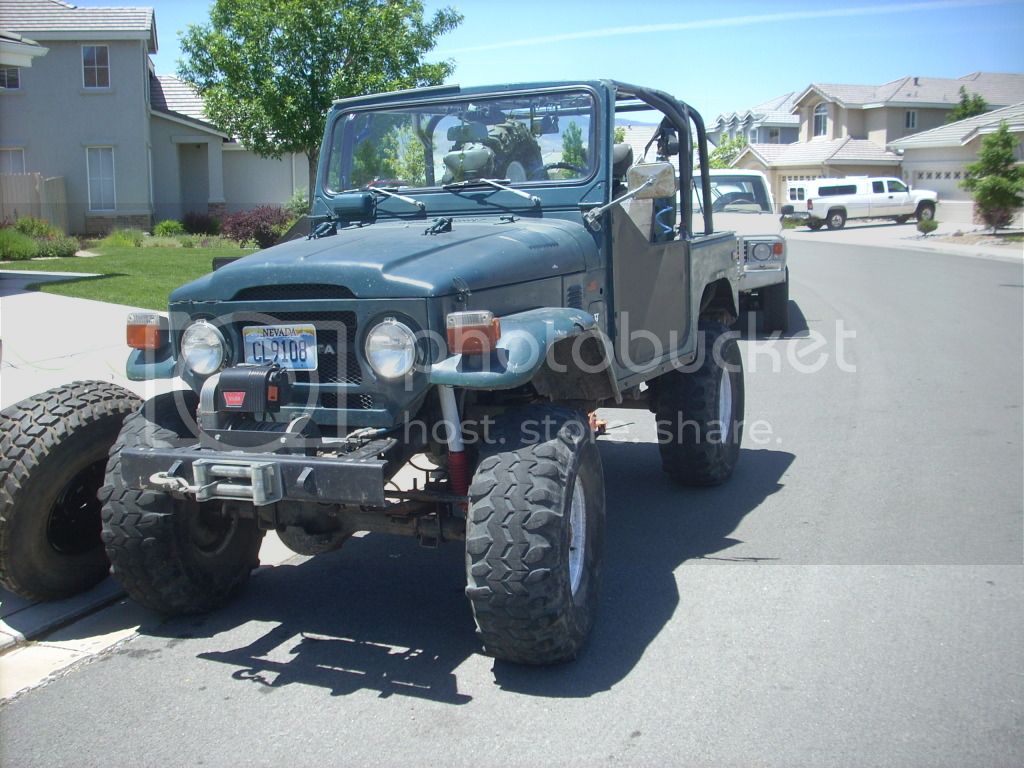

Just thought I'd share this. I'm on a tight budget and the Trail Worthy Fab tire/wheel combo was a deal I couldn't pass up. These will be going on my FJ40, replacing the well worn 36" TSL swampers it has had for these many years.

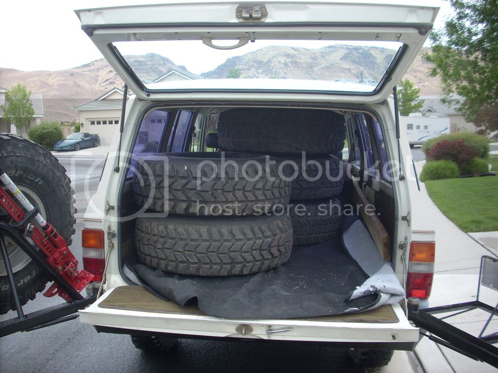

Who knew you could stuff so much tire into an FJ60?

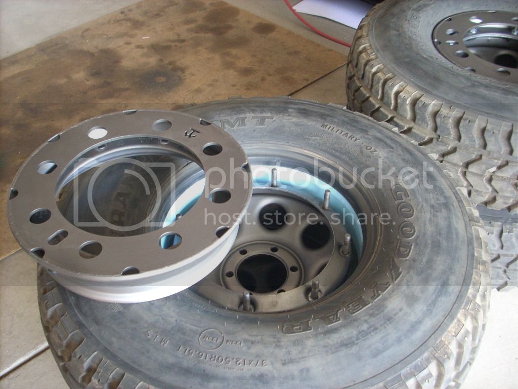

Rock Rings to protect the bead lock bolts
Half way there
The other side

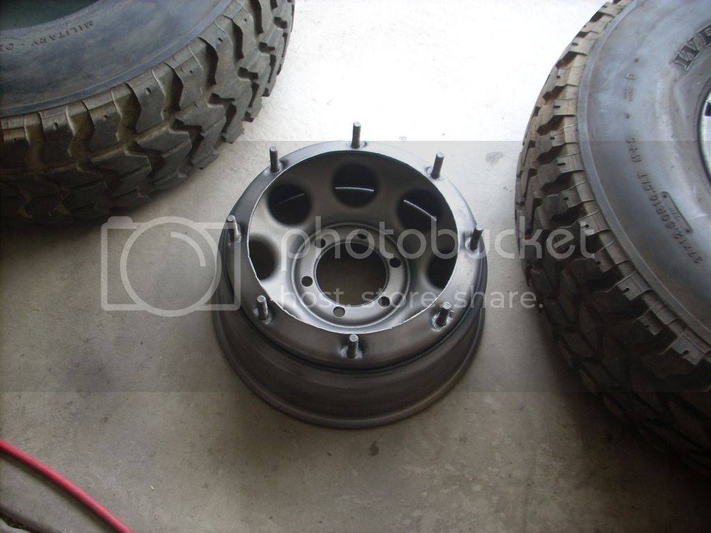

The O-ring seal
The PVC insert that makes it a true double bead lock wheel
Epoxy goodness to protect the wheels from rust
Four of the five wheels ready for paint

I ended up breaking down and re-assembling 10 of these tire wheel combo's,
5 for my truck and 5 for my son.
You want to eat your Wheaties before you start, this is a tough job and a lot of work. $50 per wheel for powder coating was looking pretty good by the end of the project.
It would be a lot easier with a 10HP min compressor and a 100 gallon tank. My little Huskey compressor got a real work out. The $95 1/2" drive impact wrench from Harbor Freight did pretty well for what it is. At 700 Ft-Lbs is was the most bang for the buck I could find.
BTW I don't think you can snap the studs off but you can strip the threads off if you over tighten.
I used 10oz of Crossman air soft pellets in each tire, it seems to work very well.
