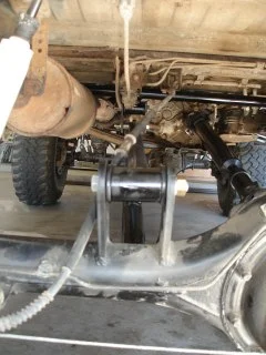

Here's a pic of mine I built!
With my design there, the one thing that I would change is the lower tube...Id have run it all the way to the END of the top tube just shy of the weld in bung at the heim...After seeing how RustyTLC's broke, I could concievebly have the same issue on my hands. However, RustyTLC's builder didnt use strongest material IMO either. These things see a LOT of stress. I used 1/4 in wall tube and I think his was 3/16. His had broken before at the weld, and him and I welded it back up once prior to the final disaster. Square tube would work too, and it might be easier to cut angles.

Chicago does work slow. But he pays a lot of attention to detail and the end result is worth it. I've never had anything he did break and his welds look good too.
I appreciate all the helpful suggestions. Maybe I can set something up with Chicago to install one, sounds like he did a great job and the pictures speak for themselves. Thanks again, Mark
