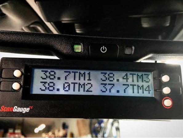

First make sure you have the latest firmware update. 4.53 is the latest.
Here are the instructions for checking it and upgrading if you need to.
Then go here...
I found that the 2nd set of codes worked for my 2007.
Now it gives you independent TPMS!
That ID should be universal. I wonder if this would work on ultra gauge MX too.
Thanks for the share.
I know the SGII had to be sent back and have the firmware updated for it to work.
