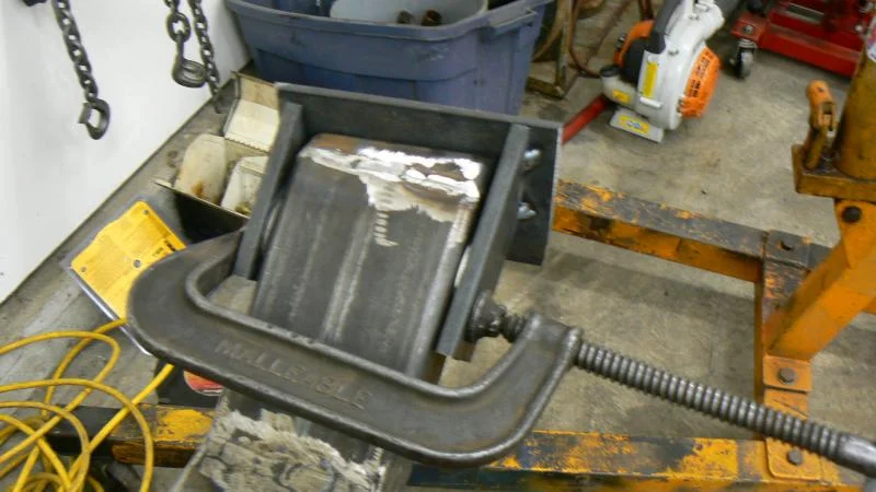

That cross member with the skid plate looks nice. You are welding the plates to the frame with holes for through bolts so you can remove it? Does it support the back of the transfer case and under the transmission?
Thanks for the good words. I welded tabs to a plate and welded that to the frame. The plate had 4 holes in the center for fill welding. The x member is under the toybox mount with tubing to the tranny mount, I cut the stock crossmember down to just the mounting holes.
