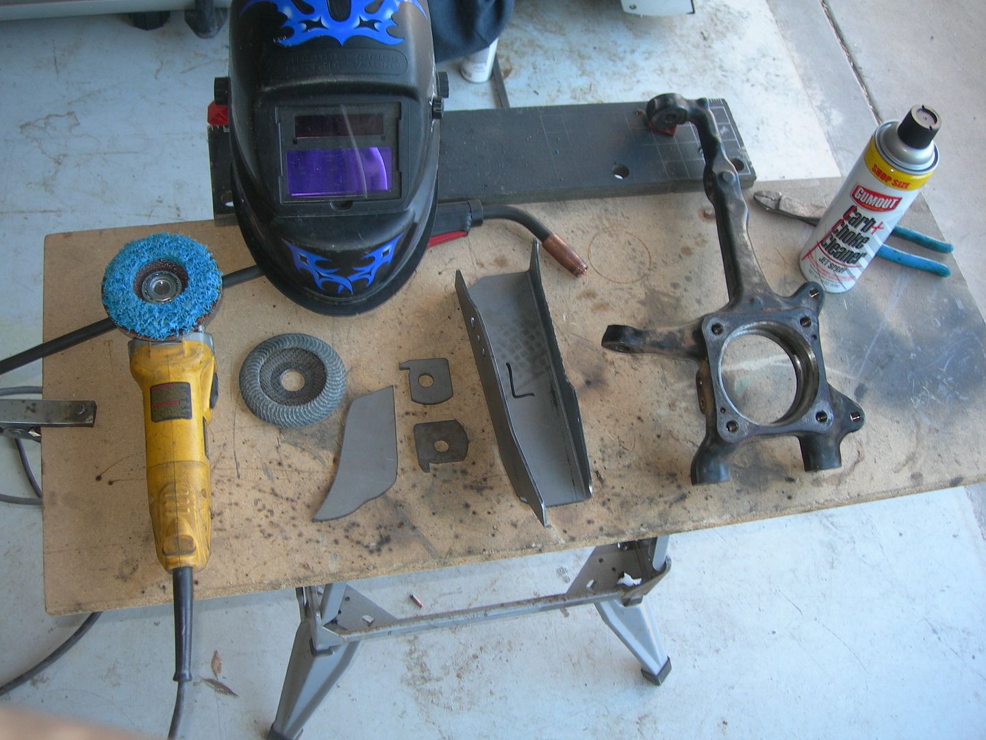

Here are a few of the tools and equipment needed for doing this modification
Gussets
Spindle
Welder
Grinder
Goggles
Gloves
Various other tools as you go

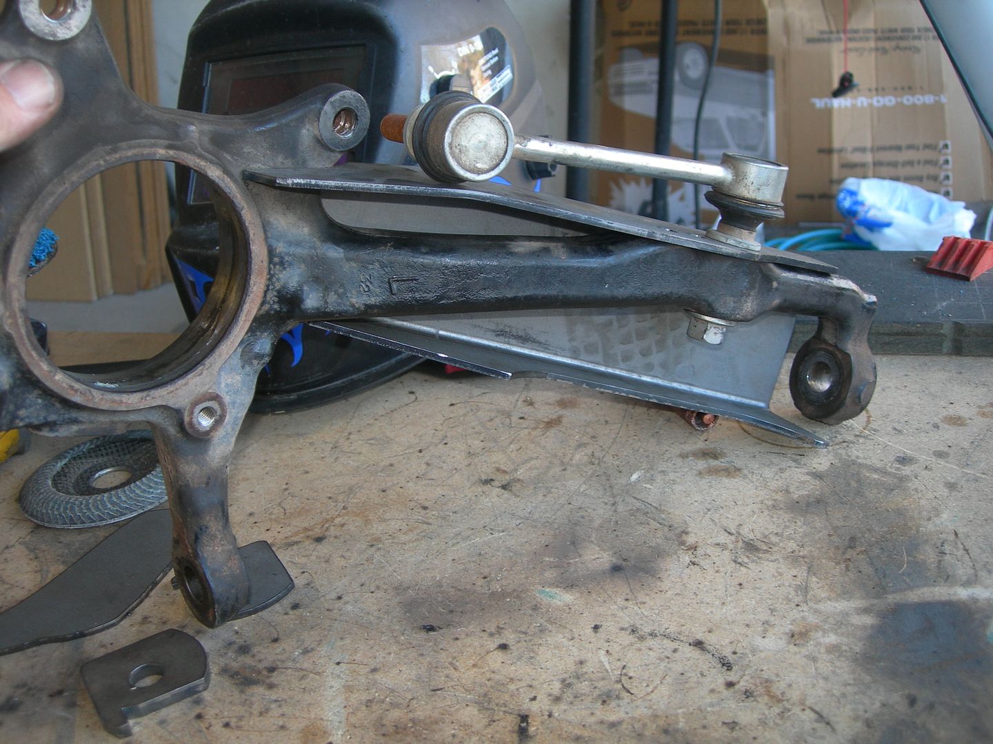

You will want to go through a series of test fit sessions

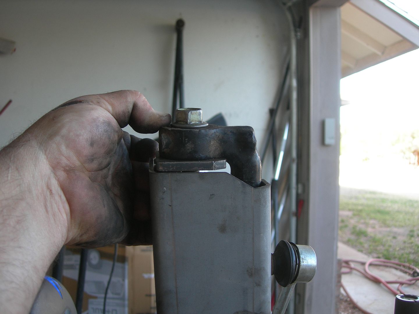

The gusset kit comes with 2 of the top plate pieces of different thicknesses
You need to use the one that fits best. As you can see the one I have here is the thin one and it has way to big of a gap
This one is much closer
Here is the added gusset that reinforces the tie rod area

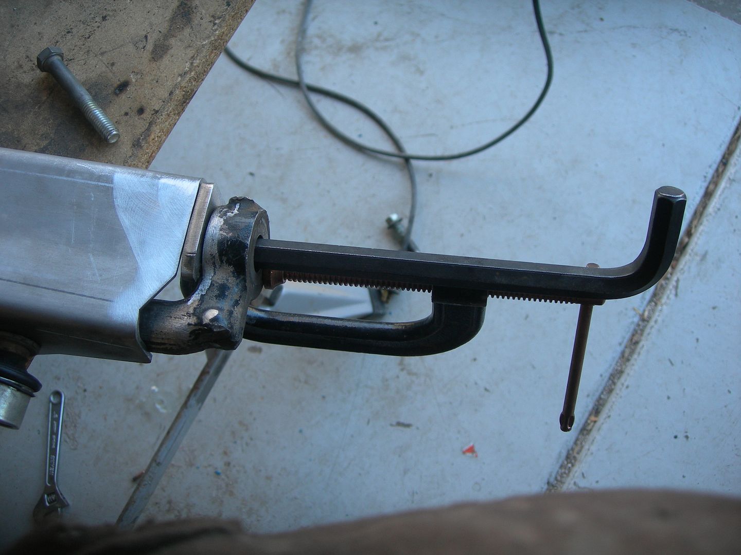

I didn’t have a bolt readily available to secure the top piece so I clamped it. To keep it center in the exsisting hole I used a allen wrench of that diameter . A little unconventional but it worked great
Installing the link, is mandatory, to make sure the hole lines up

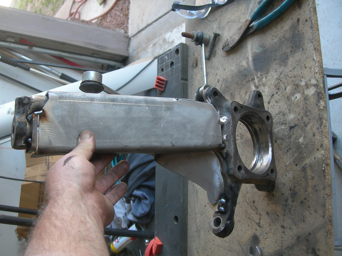

After cleaning everything with carb cleaner, I tacked everything into place

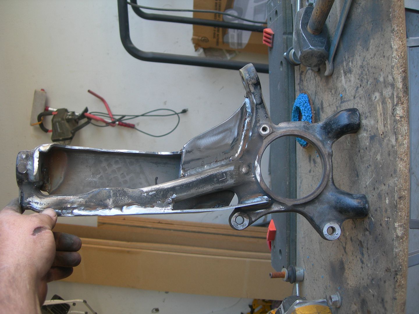

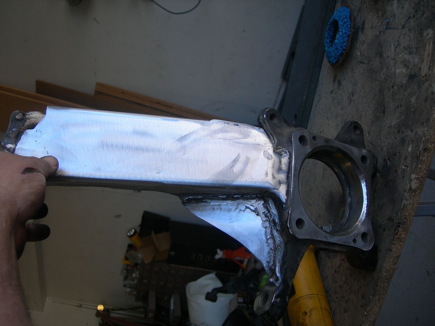

I welded it in different areas, to keep the heat down. Eventually after some cleaning up, it looked like this

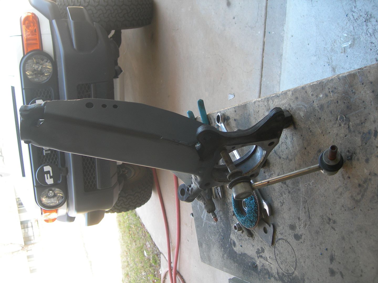

Then some black paint.
Installed
