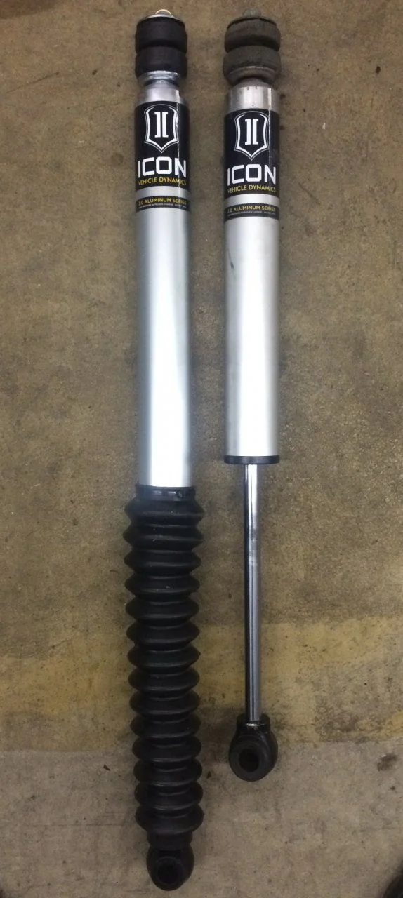

I don't think you necessarily need spacers. I have the Metal-Tech links with Icon "overland" spec springs (long travel, progressive coil) and Icon long travel 2.0" shocks. It provides plenty of travel. You'll want to add extended bump stops to keep your wheels out of the fenders though. I got those from M-T as well.
Stage 1 Icon 2.0" long travel versus standard Stage 1 Icon 2.0"

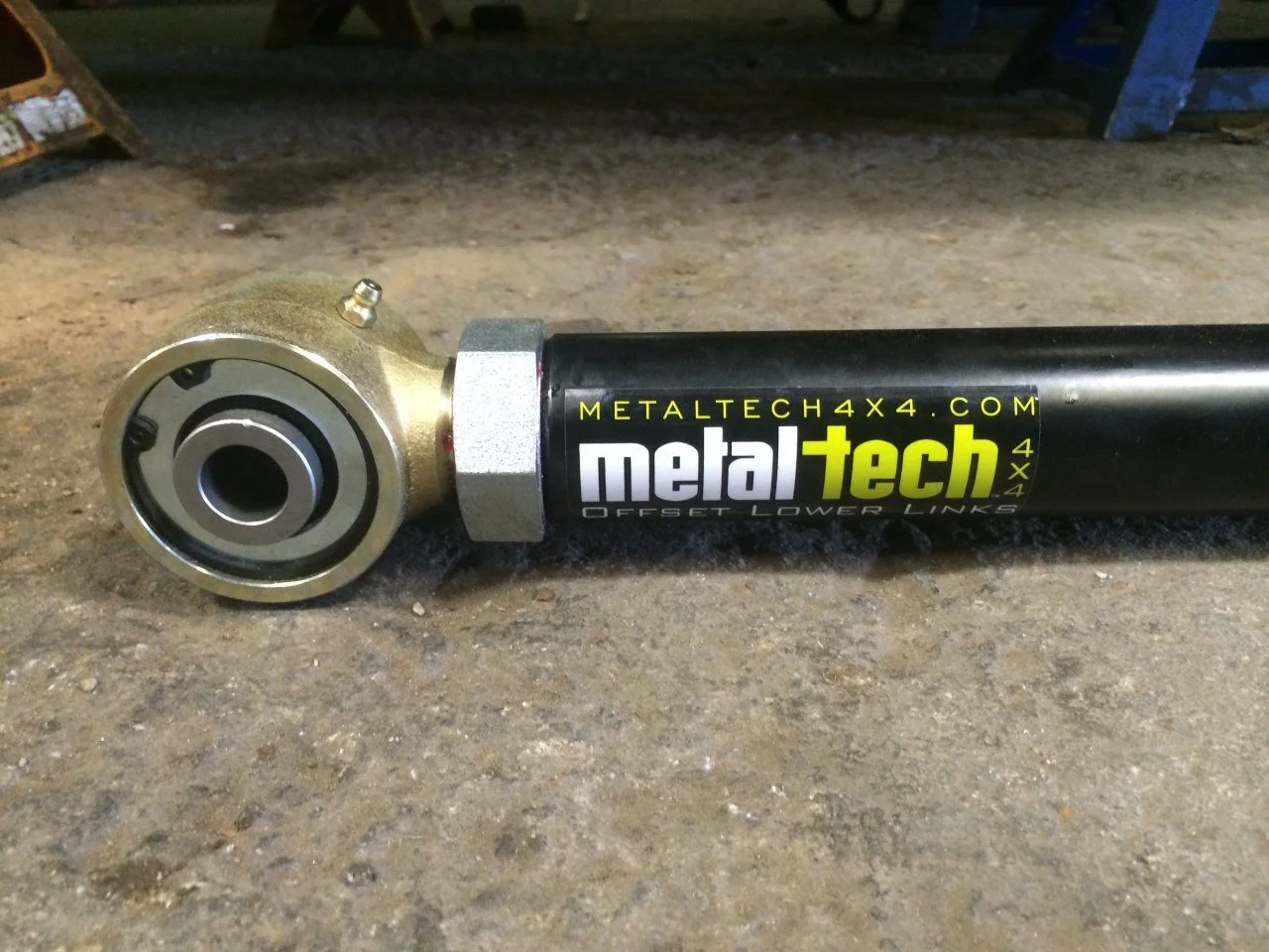

The new lower links really help with articulation by replacing OEM rubber bushing with a johnny joint.
