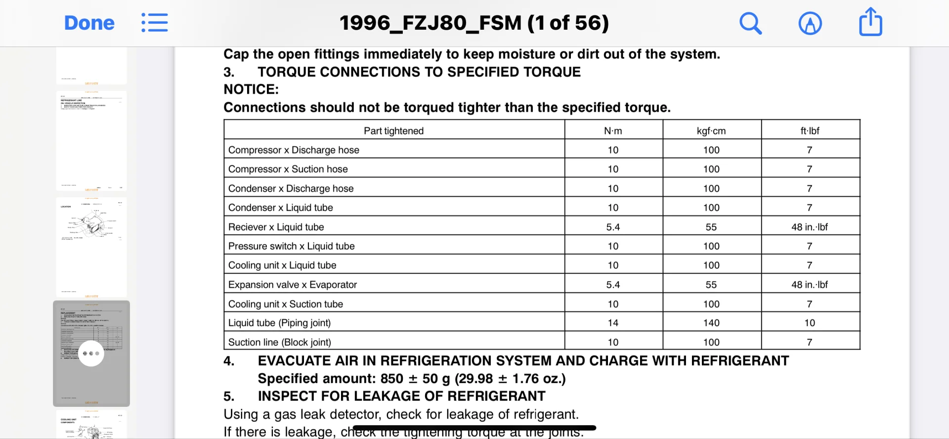

Replacing all the o-rings and flushing system and can not find a torque spec for the four Allen bolts on the top plate of the compressor.
Not listed in AC FSM section and I went through quite a few posts on here and can not find it. I may have also missed it being impatient because I'm trying to get this thing back in. Would greatly appreciate it if anybody has this listed anywhere. Only thought was to do 10nm/7ft ibs because almost all the settings are to that.
Thank you for the reply! Unfortunately, that's the same chart in my 97 hard copy. It's missing the top plate (service valve??).
For future reference for anyone else I found a Japanese denso manual for a similar compressor. It lists the torque settings as 24.5 NM / 18 ft lbs. Going to try that I guess and pray nothing snaps.......
