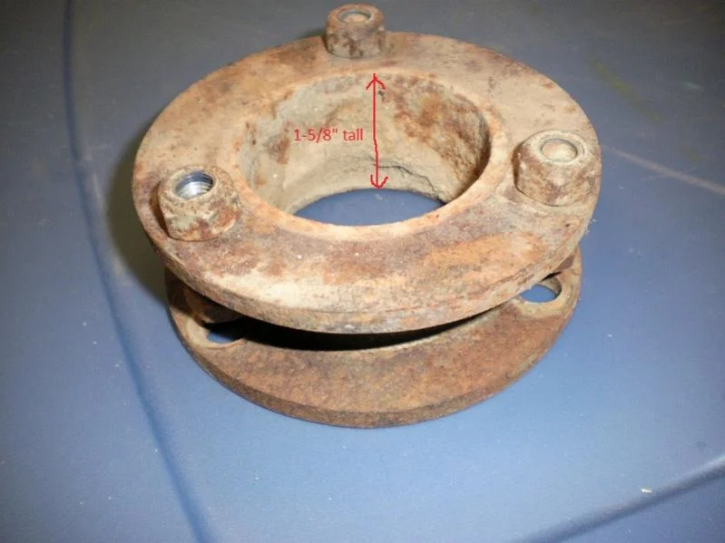

I built my own front spacers from schedule 80 tubing and 1/4" plate steel.
I had them on my truck for about 70K miles and only removed them to install C/O shocks!
They worked great and I am putting them on a friends truck after they get a new coat of paint.
I'll get pictures and some dimentions up after I get home. :cheers:

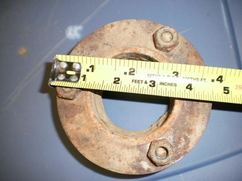

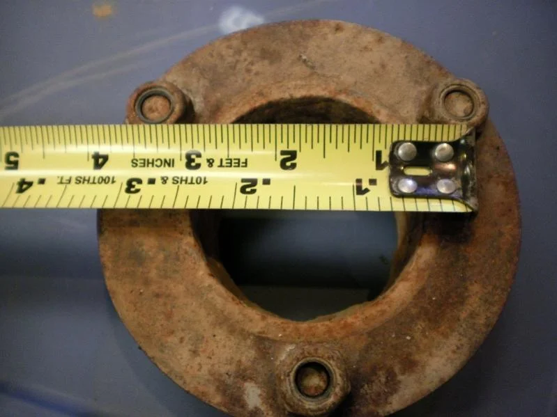

Here are some pics of the spacers that I built, installed and ran for about 100K until I bought c/o shocks.
Bolt holes are 1/2" dia.
The center ID is 2"
3-1/4" center to center on the bolts pic #3
Flange is 4.5" across pic #2
Today it may be easier & cheaper to buy them like Dini did - but the spacers performed fine and allowed me to run 33" pizza cutter tires.
