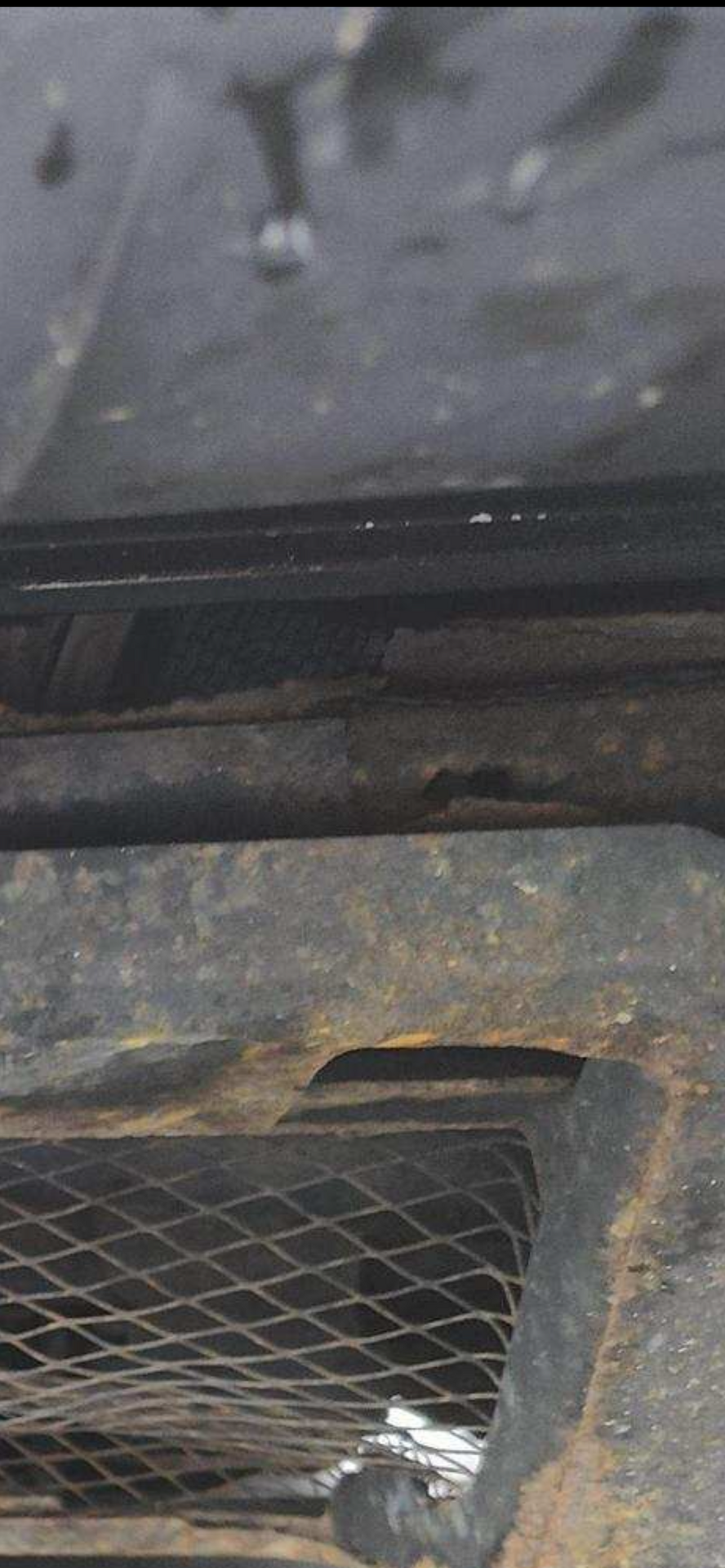

I spotted a GX near me that looked immaculate until I asked for pics before making the hour-long journey to see it in person. He only sent a few but it was concerning, especially the zoomed in photo. I had an LX470 so I'm not new to the vehicles, but I'm not sure what the basket and screen thing are and when I zoomed in there looks to be hole in some metal but I can't tell if its the frame or something else. Does anyone have an opinion? I was planning to take it to a Lexus dealer not too far for a PPI but if the rust is too much no need in wasting the time and money.
KDSS accumulator looks rusty. The radiator support frame looks rusted to hell. I would skip this one.
Go South and then use Fluid Film/Woolwax yearly. I did 7 years ago and my frame still mint in Ohio.
I appreciate the reply and info. That's what I was feeling and fearing. I don't want to go through the hassle of a long-distance buy. I lucked up on my old LX. They must have treated the underside of the 2002 with better stuff, because I gave it to my mom when her RX300 died and its still relatively rust free.
Agreed, I'd skip that one. Looks like it's passed the "surface rust" zone and entered "structural rust".
To be honest, your chances of finding one with a decent frame in Chicagoland are low, unless the P.O.s were diligent on rustproofing. You don't have to go all the way south either - vehicles down here along the I-70 corridor have some rust, but nothing like you all have north of I-80. Mine was a local MO rig - I've broken off a few bolts and that's it, and I've since stopped any further rust progression via routine Woolwax/Fluid Film treatments.
I also found a fair number of GXs for sale in places like Nashville, Tulsa, Memphis, Little Rock, etc. when I was looking, but was ultimately lucky enough to find one within 3 hours of home.
Hard pass.
