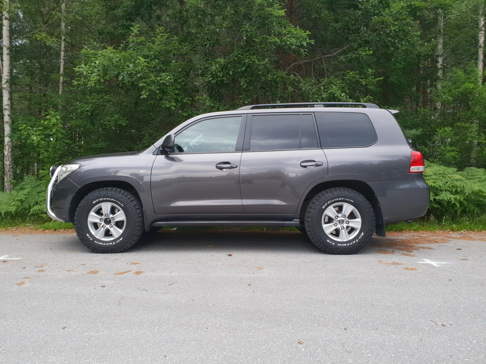

It is solved now. The tires mentioned above indeed fit without any rubbing on the right offset rims.
Thank you again for the input gaijin
Here is a picture of the result:
Ps. lost the login info for the "Andh" account, as for the last reply coming from another (but similar enough for recognition I hoped) alias.
No worries about that (from my side atleast) though.
So yeah, as stated above, big thanks again for the guidance in the right direction which finally led to the result in the pic above.
