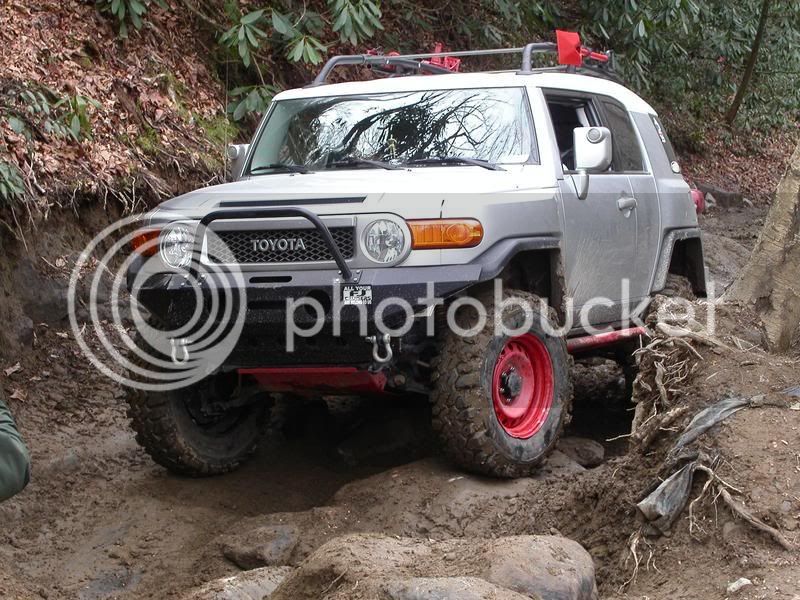

Mine with my Swampers on:
Thanks for your help. I am not too interested in going any wider thatn the 285's, but I would like to get taller tires to help fill-in the big gap left after the lift. I like the look of the 'pizza cutters' as well. Mostly, I want to make sure I have good tires that will last and do well on and off road and not hydroplane with all the rain we get in the Pacific NW.
