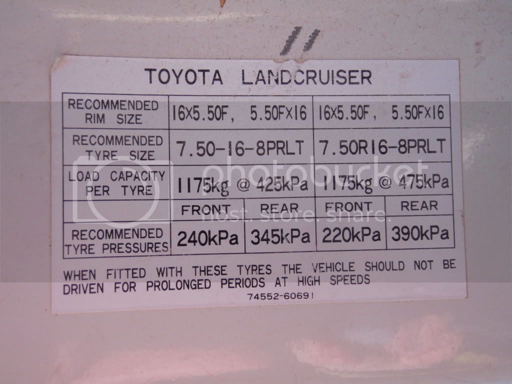

gday all.
Im looking at tyres and rims today.
My HJ75 came with non standard 15inch rims with 265/70R15 tyres on it.
They look a bit puny, the speedo is off and clearance ain't exactly good.
Can someone please advise me how to read this label regarding recommended trye and rim sizes?
I'm guessing the 16 means 16inch Rim.
What does the 7.5, 5.5f refer to?
:beer:cheers Sean
I'd say that the 5.5 refers to the stud spacing for your rims, 5.5 inches across hub stud to stud. This is a standard Toyota configuration, also is used on chev/Gmc( at least on older models) . As for the 7.5 I'm not to sure, tire height/width?
Joel.
I think that for 7.50-16-8PRLT:
7.50 is the section width in inches.
16 is the rim diameter in inches.
As for the rest, I'm not sure, but I have read (it may have been on this site!) that the aspect ratio is fixed at 92% of the section width wherever the width ends in 0 (as in 7.50). I do not know whether this is correct. Using this, however, with a width of 7.5 inches the sidewall height = 0.92 * 7.5 = 6.9 inches. This would give an overall diameter = 16 + (2 * 6.9) = 29.8 inches
In relation to "8PRLT", the "PR" means "Ply Rating" and the "LT" means "Light Truck". A ply rating of 8 is equivalent to load range D and load pressure of 65psi.
16x5.50F refers to the rim - 16" x 5.5" wide, and I suspect the "F" indicates a "split rim" (Flanged)

The 7.50x16 are still a different size,although they are very close. They are still sold worldwide and fitted to Landcruisers new.
Im guessing the 7.50x16 are more common in oz than the 235x85x16
i found me an infomative tyre gizmo on exploroz.com Tyre Size Calculator @ ExplorOz
it figures the 7.5R16 gives an outer diameter of 786.4mm or 30.9inches.
Rosco your 235/85 R16 gives an OD of 805.9mm or 31.7inches.
