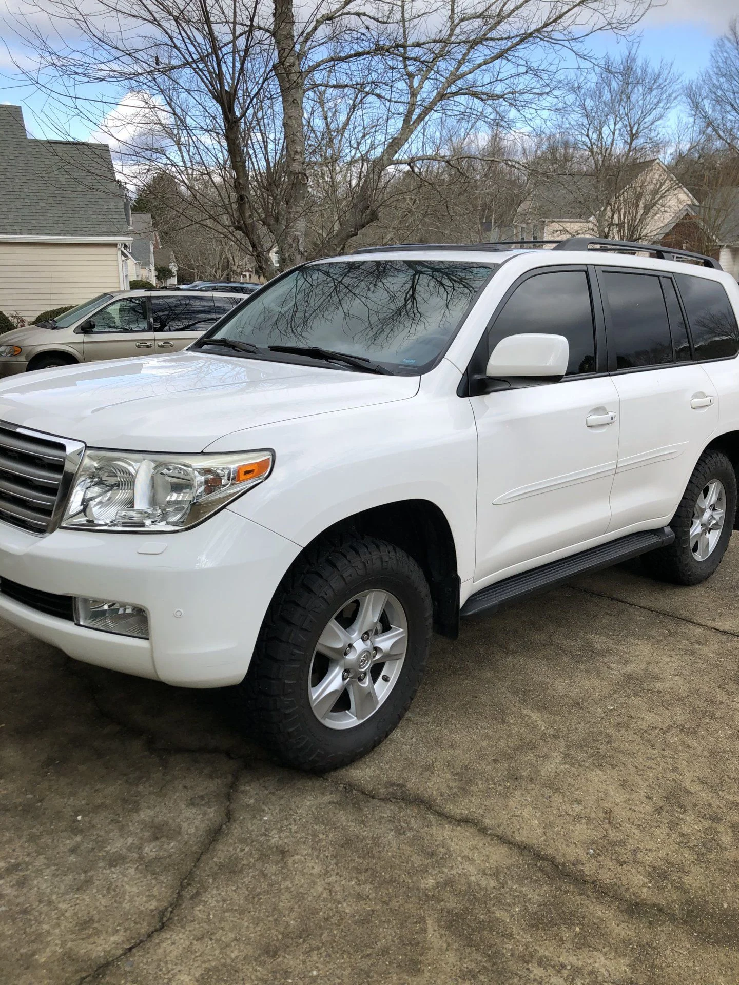

I went with the OME / ARB leveling Kit and then put on Nitto Ridge Grapplers 285 * 65 * 18. No rubbing or clearance issues. I had T/A KO2 285*60*18 before and these tires look and ride better.
