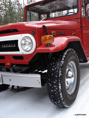

Standard in Africa, Asia, Australia, Europe & South America (since the 60`s until the 80`s) was a 7,50/85/ 16 tire
see my
RED , I have this dimension , it`s a Cooper tire, I bought them three years ago .
An alternative would be a 235/85/16 tire.
Hope it helps
Cheers
