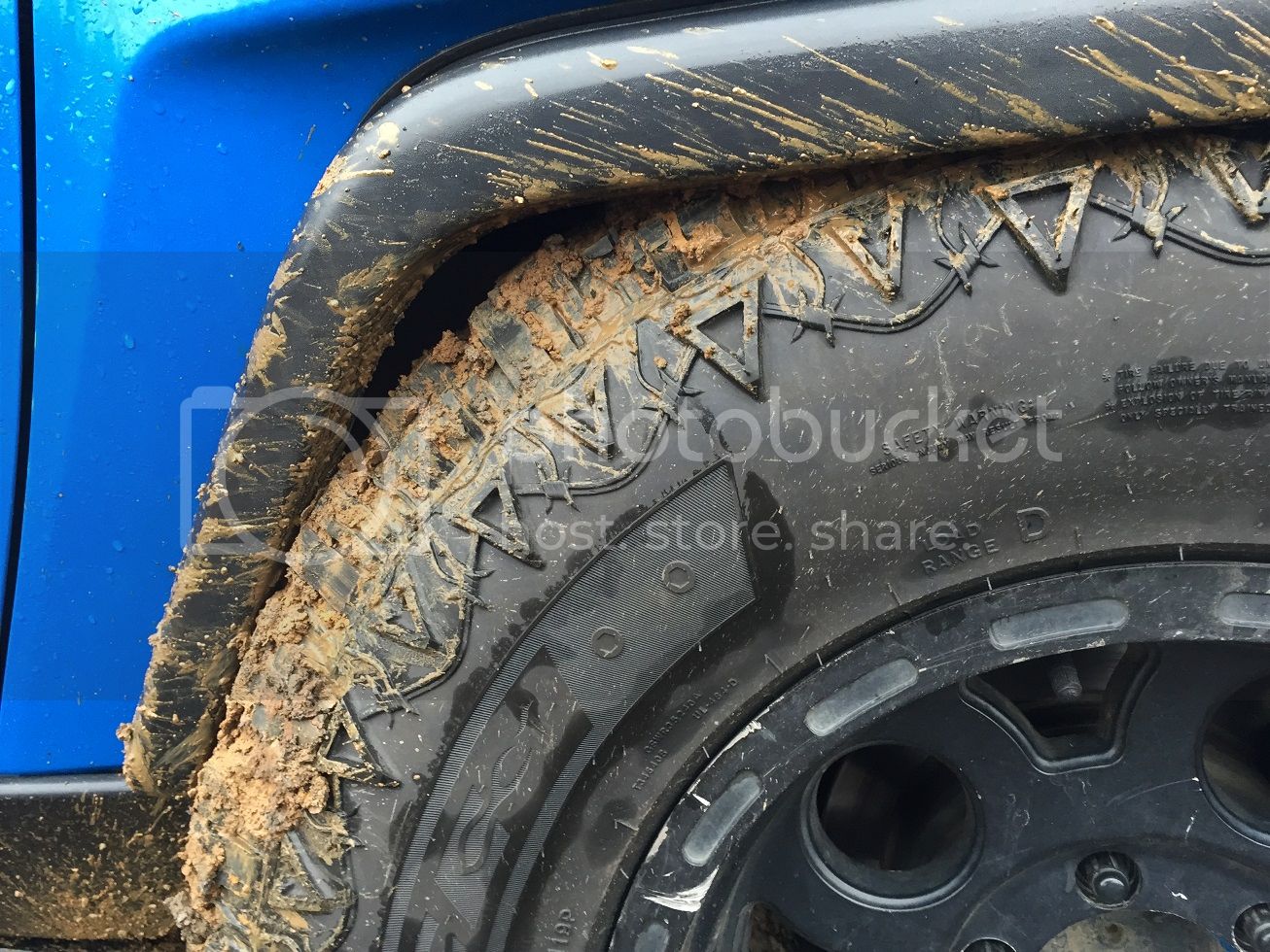

Rubbing bad in the rear after going to 35's. Its only on the rear flare toward the front.
So i have two options. Im running 1.25 Spidrtrax spacers. I can remove them from the rear or remove the flares all together.
I'm leaning toward removing the flares but worried about body damage from slung rocks.
fjf35_zps1278c0f2.jpg~original
Are you rubbing just driving or are you rubbing when flexed out
IMHO I would remove the spacers and get extended bump stops. They will still rub just not as much.....
Ummm, you are running 35's and expecting it NOT to rub? Not sure who gave you advise but running anything over a 33" and wider than a 10.5, you are going to rub. Adding the wheel spacers will do no good until you get 2.5" if I recall.

So, you expected it to rub. If "many run it with no rubbing", what are you doing different than the "many" to get it to rub. Did you modify the body mount to run the 33's? As you can see in your picture, there is no where to go, why most I know kept the tire inside the wheel well or installed extended bump stops to reduce uptravel/stop rubbing.
Removing the flares won't give enough clearance taking the wheel spacers off won't bring the wide tire inboard enough to clear, but that's speculation looking at your picture.

Im sure you dont mean to be argumentative but there is no argument to be had. I already knew removing one or the other will stop the rubbing. I was only asking for opinions.
I expected it to rub in the rear because unlike others, im using a 1.25 spacer.
Removing the spacers from the rear will stop the rubbing, or removing the flares will stop the rubbing.
Like I said in the OP
"So i have two options. Im running 1.25 Spidrtrax spacers. I can remove them from the rear or remove the flares all together. "
But dont worry about it. I decided to just remove the spacers and its clearing with zero rub now.
