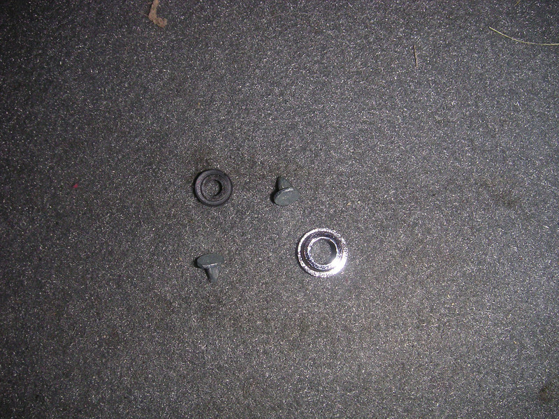

First remove one nozzle cap with a flat blade screwdriver, remove the rubber washer and the two metal cones:
When you are inflating the tire, the valve stem forces the cones together and against the opposite washer, sealing shut the unused side of the inflator but allowing air to pass in to the stem side. Before the modification, when you pull the inflator away from the valve stem air pressure will force the cones apart and drive them into the rubber washers on both sides, preventing air from escaping. This is fine if you have an air tank with a pressure switch, but is a problem for the simple DC compressors like the Q-Maxx.
Now crazy glue the two cones back to back. The cones pictured here are out of a different inflator. Let the glue set up for a while so it does not contact the rubber washer.
Now reassemble. While the inflator is pressed onto the valve stem, everything works as before. When you pull the inflator away, the glued together cones don't seal shut so air can still pass through.
