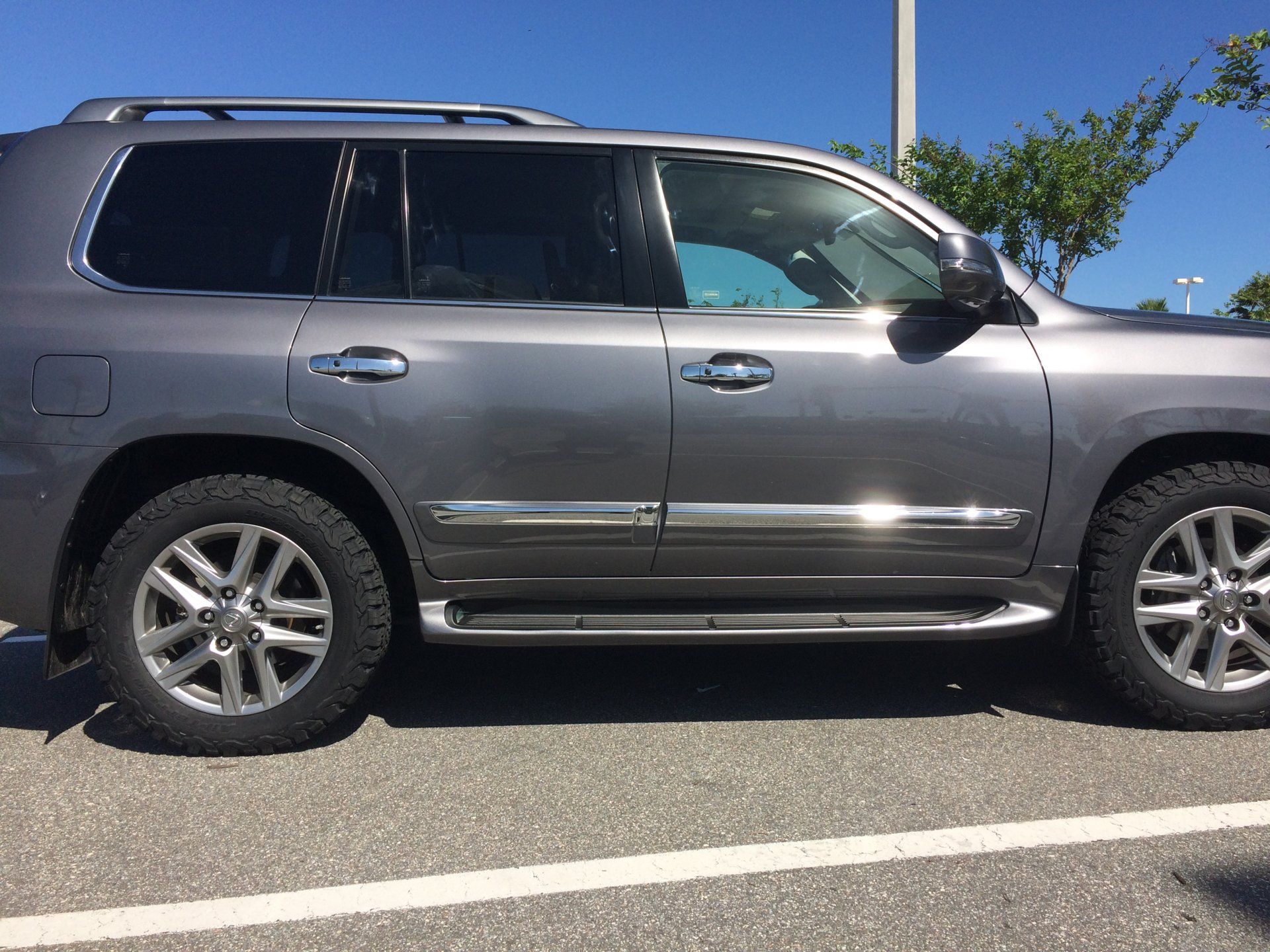

Mine are 285/55/20 BFG A/T KO2’s “D” rated. Use them for Mall Crushing ;). Wear like iron. Snow rated. Plus should be OEM for this 6000 lb SUV. Look good

Most any highway tire will be quieter, more comfortable, have better braking, handling, and fuel economy than the K02. But they won’t look as cool.
The K02 is a big, heavy tire and adding unsprung weight is never a good thing.
For highway use, something like the LTX MS/2 is a great tire. For off-road, the K02 is a great tire.
For snow, nothing will beat a dedicated snow tire like Nokian.
