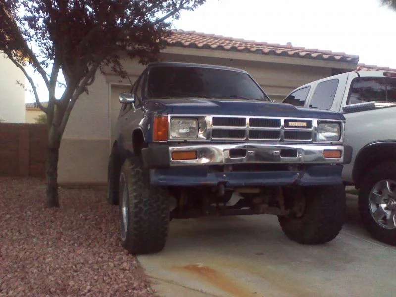

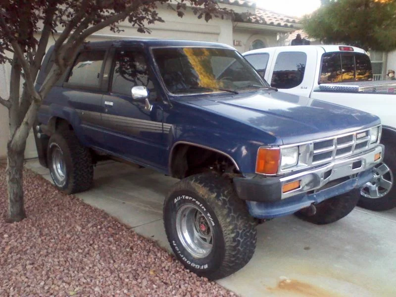

This is arguably the worst year for this rig. California made Toyota put way too many hoses and check valves on this thing. But, I've had it since 98. It looks as cool as the other first gen runners, especially with the top off. I'm gutting the interior which wont be hard as it has more or less rotted away over time. All those cheap plastic panels will be replaced with diamond plate. Basically, I'm keeping the back seats and the roll bar. I put a 4" lift on it many years back and I'm going to leave it that way. I like the way it looks. I like the IFS believe it or not. I'm not going to climb rocks with it. Mud, yes. Sand, yes. Trails, for sure. It will be a daily driver designed to handle 80-90% of what I throw at it. The other 10% will be admired from a distance as I watch others tackle it. No SAS planned. Here comes the reason for the thread. The power plant. The stock 22re is way too under powered for this truck. I know what a Tacoma 3.4L would do for it. It would fit the engine bay just fine with a little welding and modification. But I'm wondering if salvaging that 4 banger with the right mods would be worth it. I've read about high performance cams and headers and cool air intakes and cat back exhausts. But after spending all that scratch will I get the same benefit as a v6 swap? New gears are in the works as well. I like the tires I have on my Tundra. I got them used off an FJ Cruiser. 265/70/17 BFG TKO's. They sit as high as the good ol 33's I have on it right now. But the 265's are a bit skinnier and a little easier to negotiate. They will look great on the 86. So throw me your thoughts people. I appreciate your advice and hearing your experiences.

Pics are coming, my bad. I have the 5 speed, but it is still a dog. If I keep the 22re then I will definitely re-gear it. I would re-gear either way engine swap or not. 5th gear is basically useless. Is there an aftermarket head swap for the 22re that has 2 cams? Move valves means more air. More air means more power. I believe there was a reason to ditch the sohc. The taco v6 would get me to 190hp stock.
