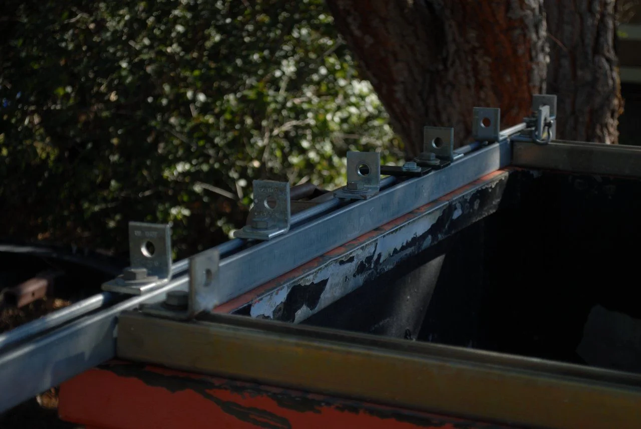

Very strong. Main con: quite heavy. Steel, heavy duty. Comes in 2 heights. Loads of fittings.

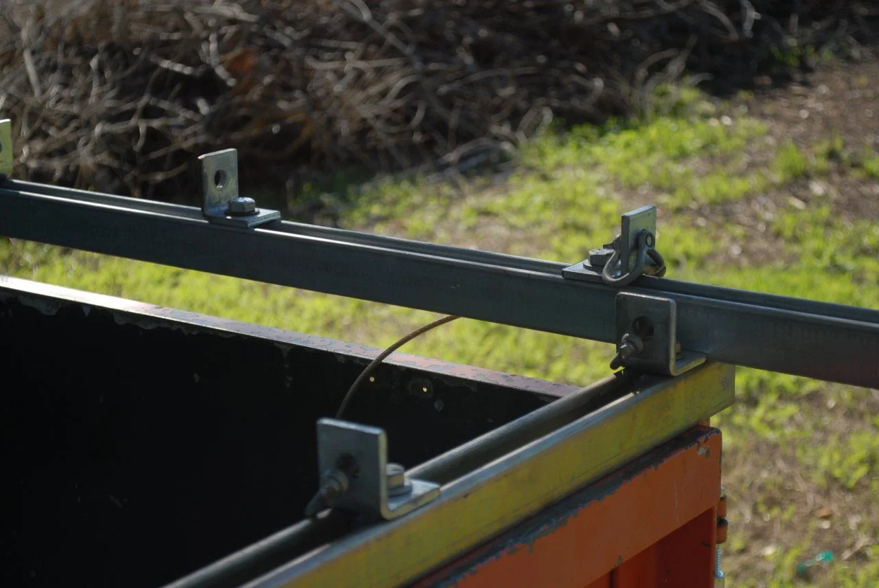

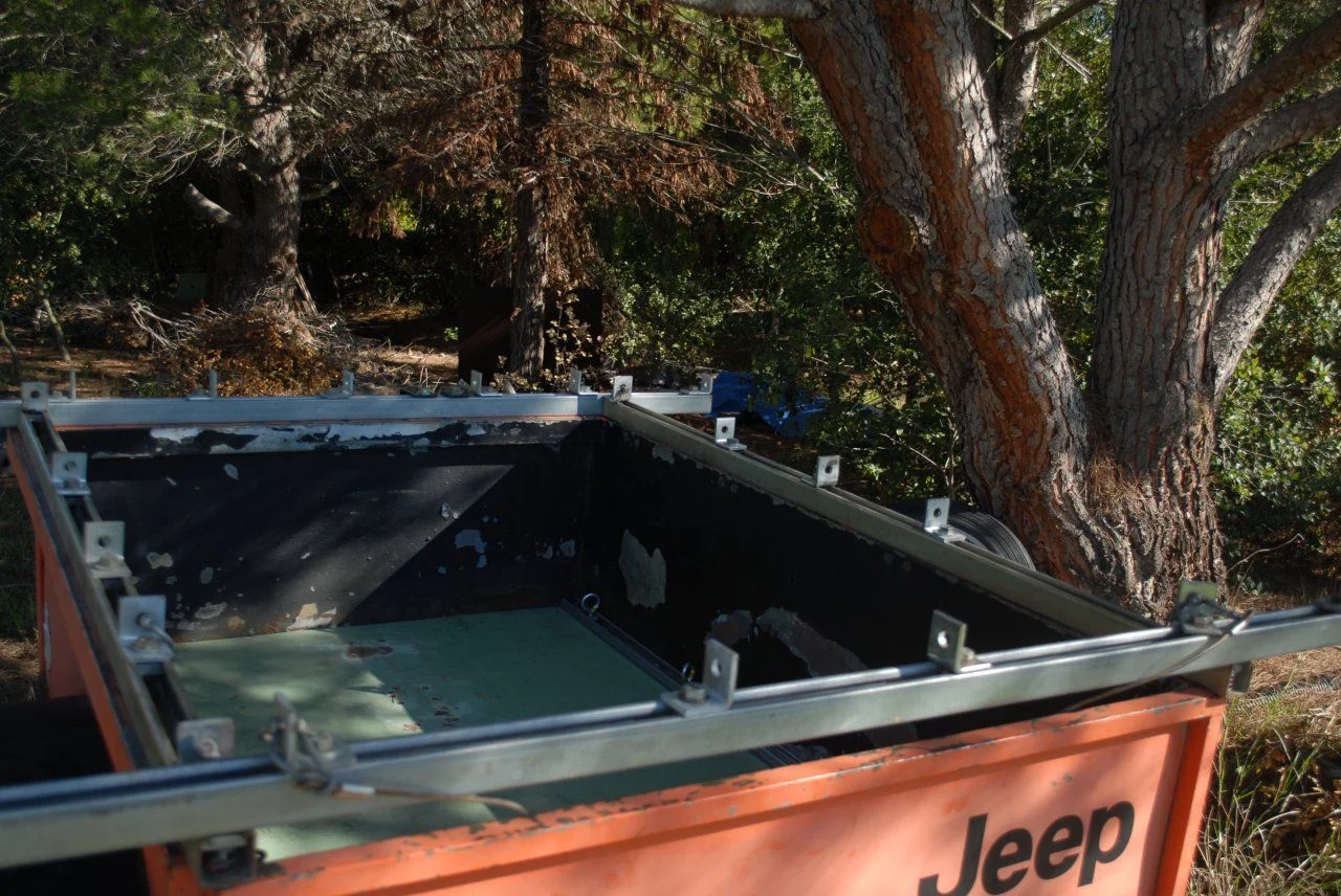

On top, rails all around. Movable tiedowns/spacers. Plan on putting large crossmembers for cargo boxes, bikes, spares, RTT, etc, as needed too.
Rear cross member removes with 2 bolts for big items loading, easy to do. Rock solid anyway. Can move a bit lower for flat top instead.

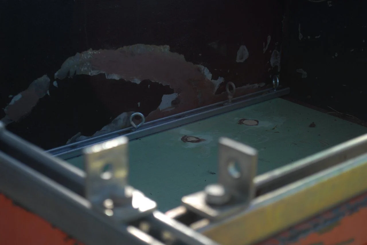

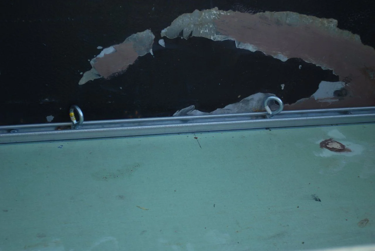

Some lower profile rails inside too for tiedowns and cargo spacers. More rails to be installed on other 2 sides.

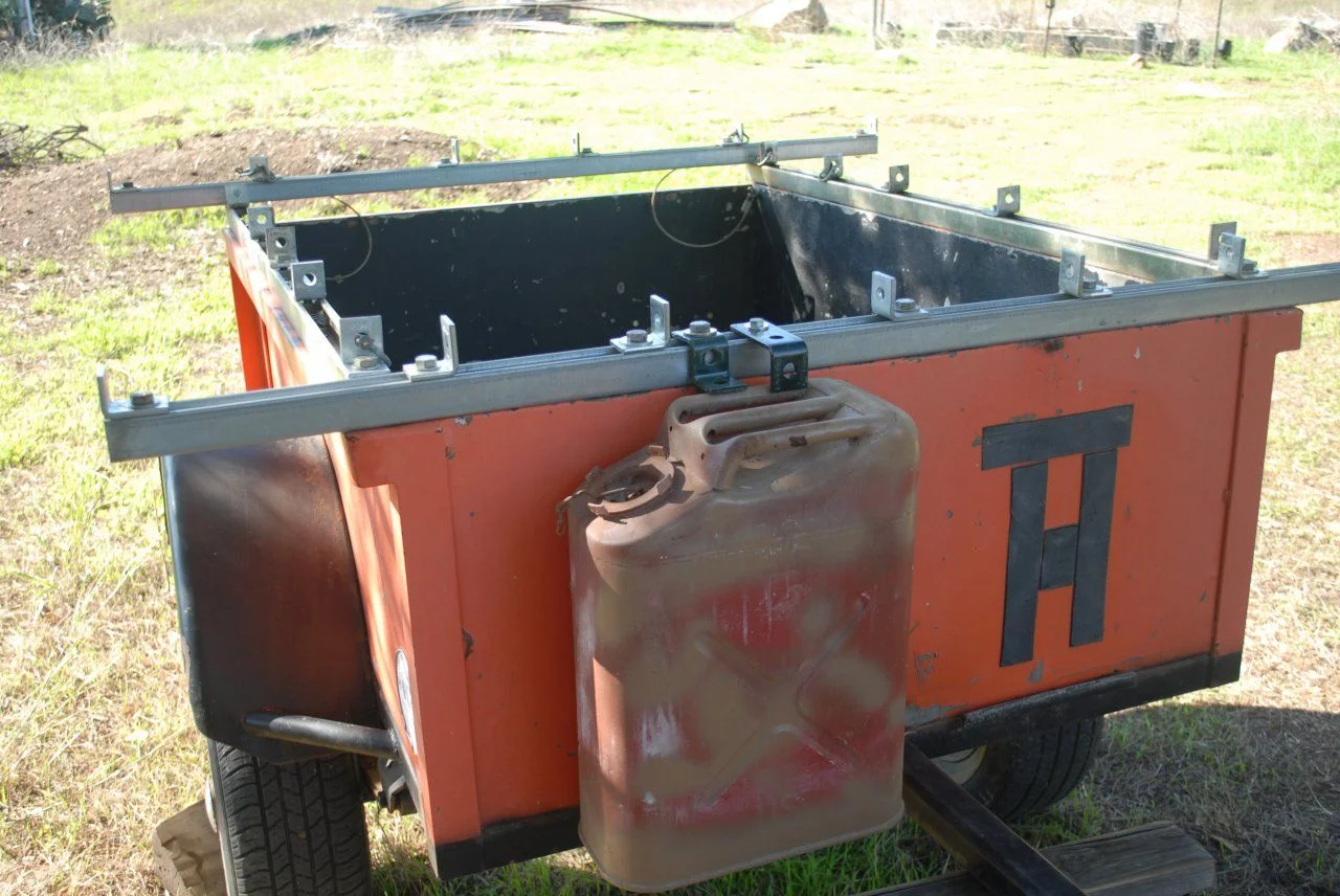

May also put some short struts on sides for cans, tanks etc.
Jerry can holders are temporary, don't get excited.
Also in the plans: removable hinged lid.

Inside lower rails
More
