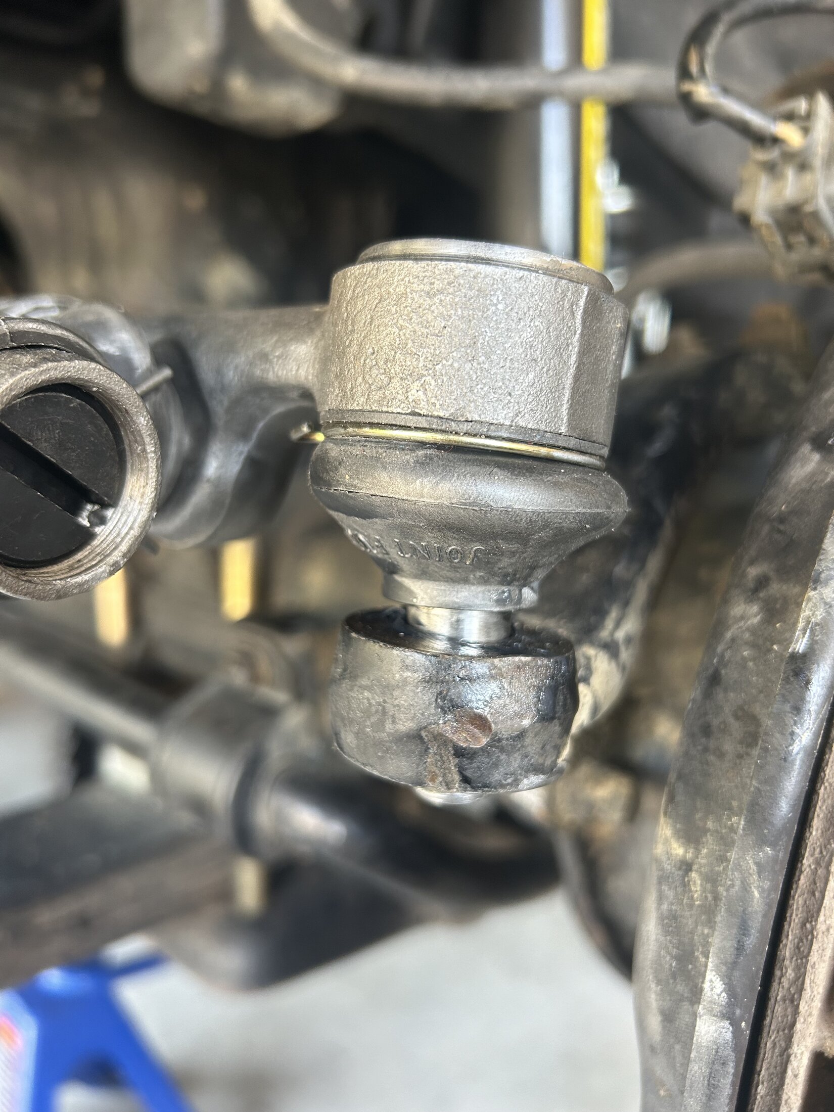

Now I’m stuck again…. I really can not get the new toe rods into where they are supposed to go. Is it supposed to be this hard? Hammering doesn’t work and screwing the nut onto the bottom just strips it out.
Picture showed after I posted. Looks like its at a slight angle? 555/Joint Fuji are differently sized than OEM. So if you just counted threads from OEM ends and tried to use that count for the new aftermarket TREs it will be a little off.
You have the adjustable ones. So do I.
You need to grease them after install.
I also found that the factory preload is fine at the beginning, but it developed some play after a while. So check after install and once in a while and ajust as needed.
