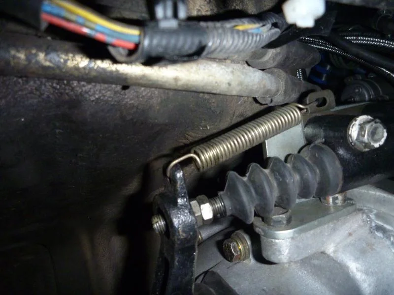

Here is my clutch set up with a Downey Bellhousing, H55, stock slave and Downey mount bracket. The spring is pulling the arm towards the slave cylinder, so pulling the TO bearing off the clutch fingers? Is this right? This is how my stock 2F/60 (9/85 year) was set up prior to my diesel swap.
Thanks,
Doug Attached Images
attachment.php
attachment.php
The pictured slave, arm, return spring are the adjustable 4/85-earlier parts. It should be adjusted so when the spring pulls the arm all the way in, bottoming out the slave cylinder, there is clearance between the release bearing and clutch fingers.
Jim,
Thanks for clearing this up for me. At least I had it adjusted correctly.
