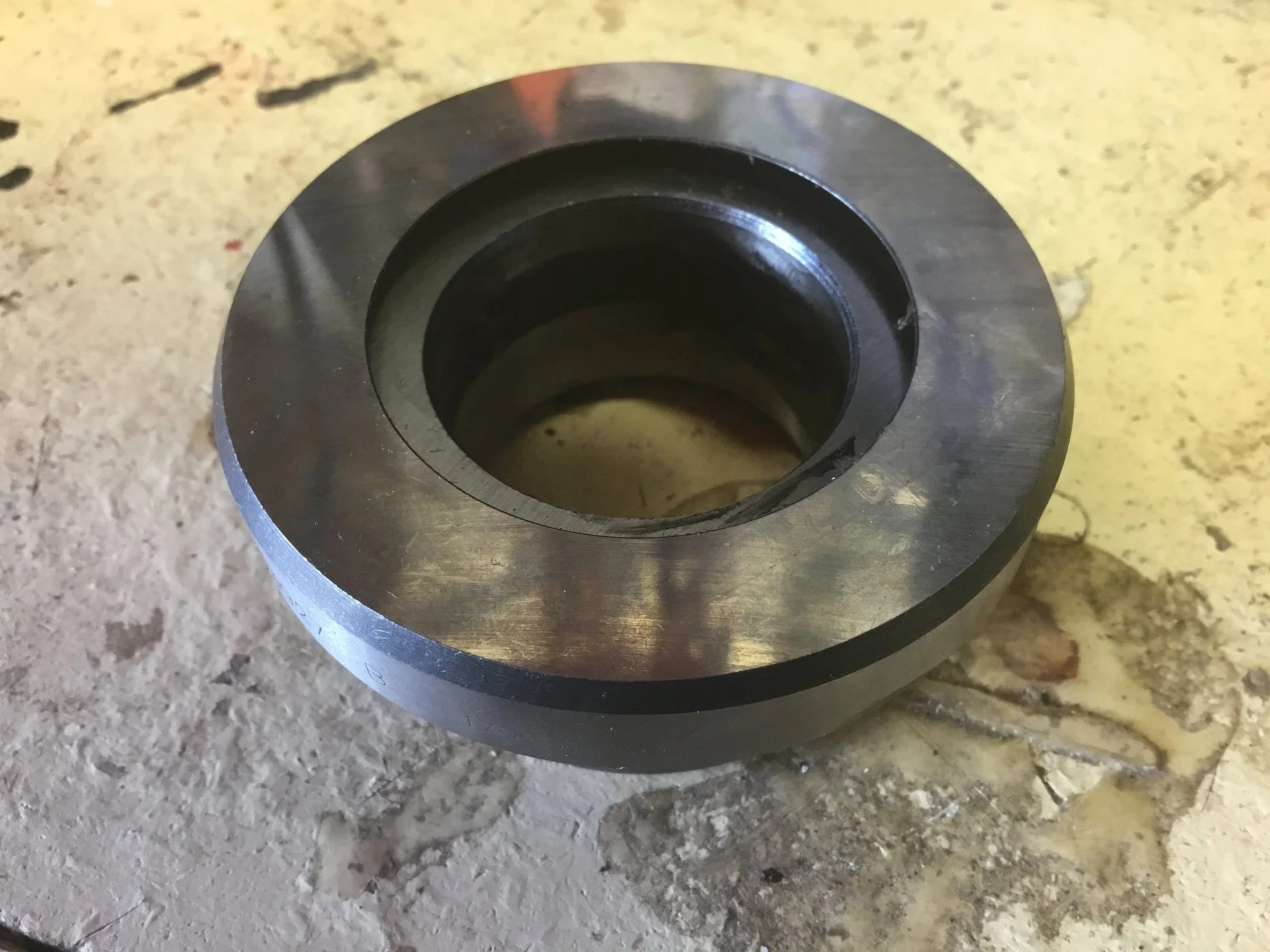

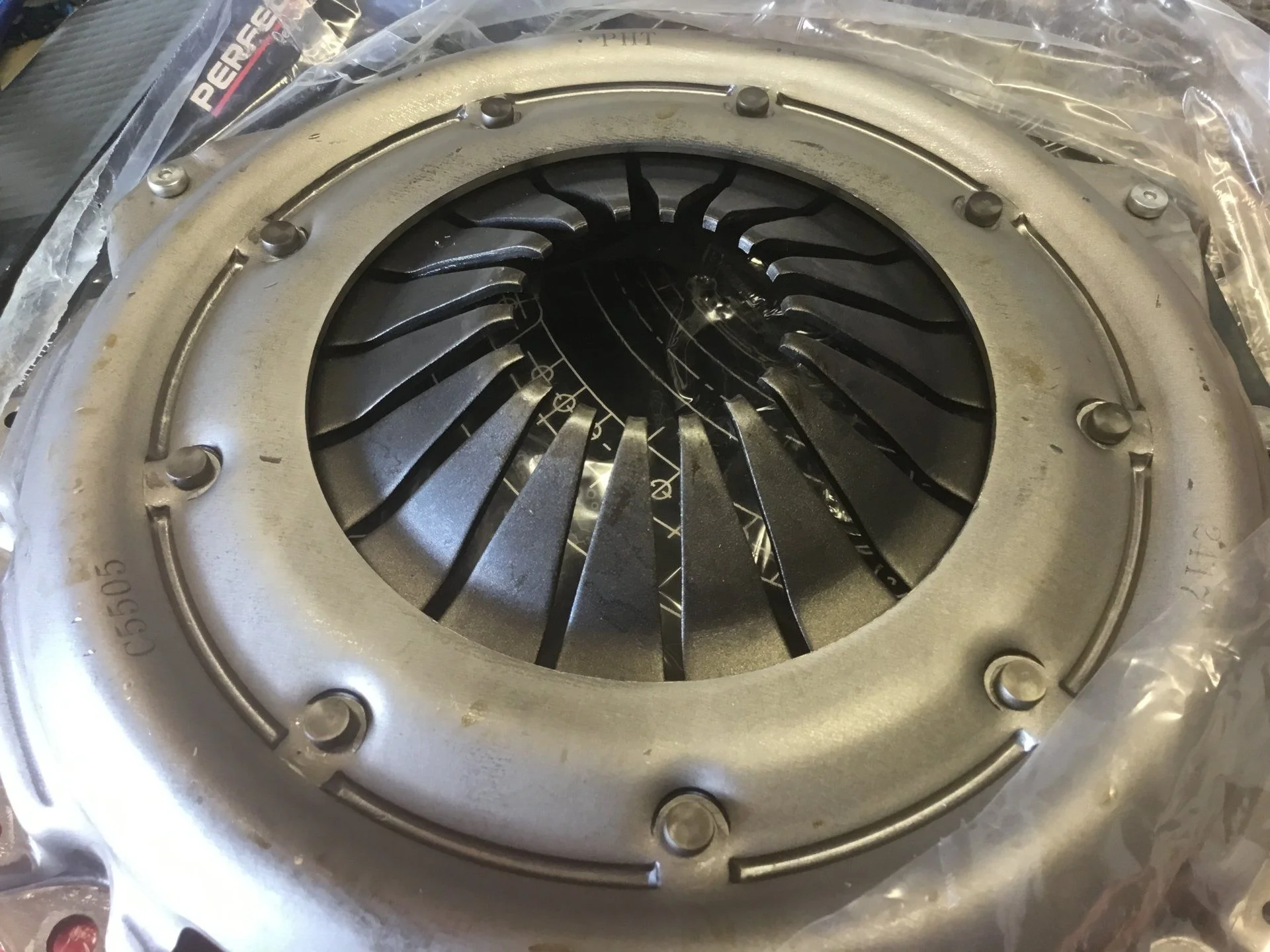

New to the forum here, and have a question. I have a 76 FJ40 with a chevy 327 engine. It has the advance adapters bell housing. I am replacing the clutch and need to know if the original Toyota style (Koyo rct52s) bearing will work with the Perfection Clutch Kit I purchased. The T/O bearing that came in the kit is a different style. Want to make sure I don't put it together and have problems with the bearing not mating to the new pressure plate correctly?
Any Help?
Kelly
The Toyota bearing will work, and should be used so that you can stay with the stock Toyota shift fork, BUT you've got bigger problems: you've got a high cone pressure plate, and you've got to use a low cone pressure plate. Next problem: I'll bet the pressure plate you've got takes about .500" travel to disengage, and the Toyota hydraulics only produces about .420" of travel at the throw out bearing- - -might I suggest one of my Chevota clutches instead????
