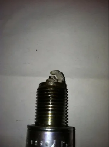

Changed the plugs today in the 22rte and I was kinda shocked at how bad they looked. I have only had the truck a couple of weeks and I know it the needs the valves adjusted, you can here them chattering when the truck is cold, it goes away when it's warmed up but as soon as it cools a little they chatter again. Would the valves needing to be adjusted cause the plugs to look like this? This is the worst one but the other three aren't much better.

I doubt it has anything to do with alcohol, it burns almost totally clean, it's the gas that burns dirty.
How old are the plugs and how were they driven? Doesn't look that bad, some wear and some deposit, would likely continue to work for a longtime?
I honestly don't know how old the plugs were, I plan on checking the new ones at the next oil change. It's funny you mention that about the ethanol possibly not being the problem, I just remembered the other day that the PO said that he almost always ran non ethanol in it. I think I will try and get in touch with him and see if he knows when the last time the plugs were changed.
