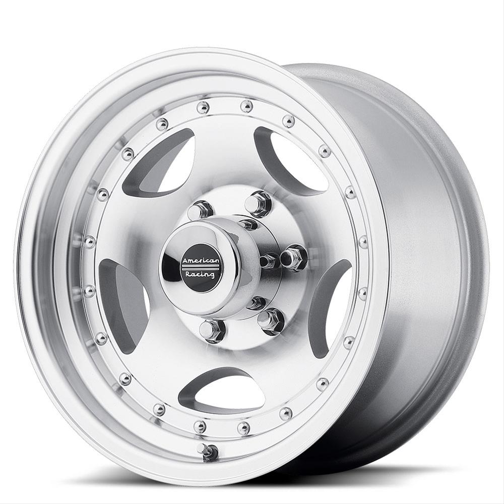

I finally have some cash to work on my '91 FJ80. I'd like to replace the wheels and want to move to some 16" wheels for ease of tyre choice. I've found these which I like and need a second pair of eyes to verify they fit.
American Racing AR1726838B American Racing AR172 Baja Black Wheels | Summit Racing - https://www.summitracing.com/parts/are-ar1726838b
16", 6 x 5.5, 4.5" backspace, 0mm offset.
They seem to ft the bill but as Im about to place the order any reassurance would be greatly appreciated.

pretty sure you need 108mm center bore size. Don't think those will work for you.

edit it might be 106mm
Uhh....someone will correct me but...8" wheel with 4.5" BS (and 0 offset) will push the wheel...in toward the spring/shock? Might have to spacer?

Here's 4.25" BS with a -12mm offset. Tires are 285/75 (33")
Have to agree. If 16" wheels offered enough options, I would rather keep the stock wheels. I went to ProComp Series 51 when I went to 17" wheels and 37s. Regardless, they should work fine. I have 17X8 with 4.25 backspacing and 37X13.5, and they only just rubbed at full lock. That's a wider and taller tire than the 35's I suspect you'll be running on 16" wheels.

I have American Racing wheels and the folks saying you need to get the specifications right are right. You would hate to order the wrong set of wheels as this type of stuff isn't returnable. I have these. Use the "check fitment" tool on Summit Racing or Tire Rack or whatever reputable site you use.
