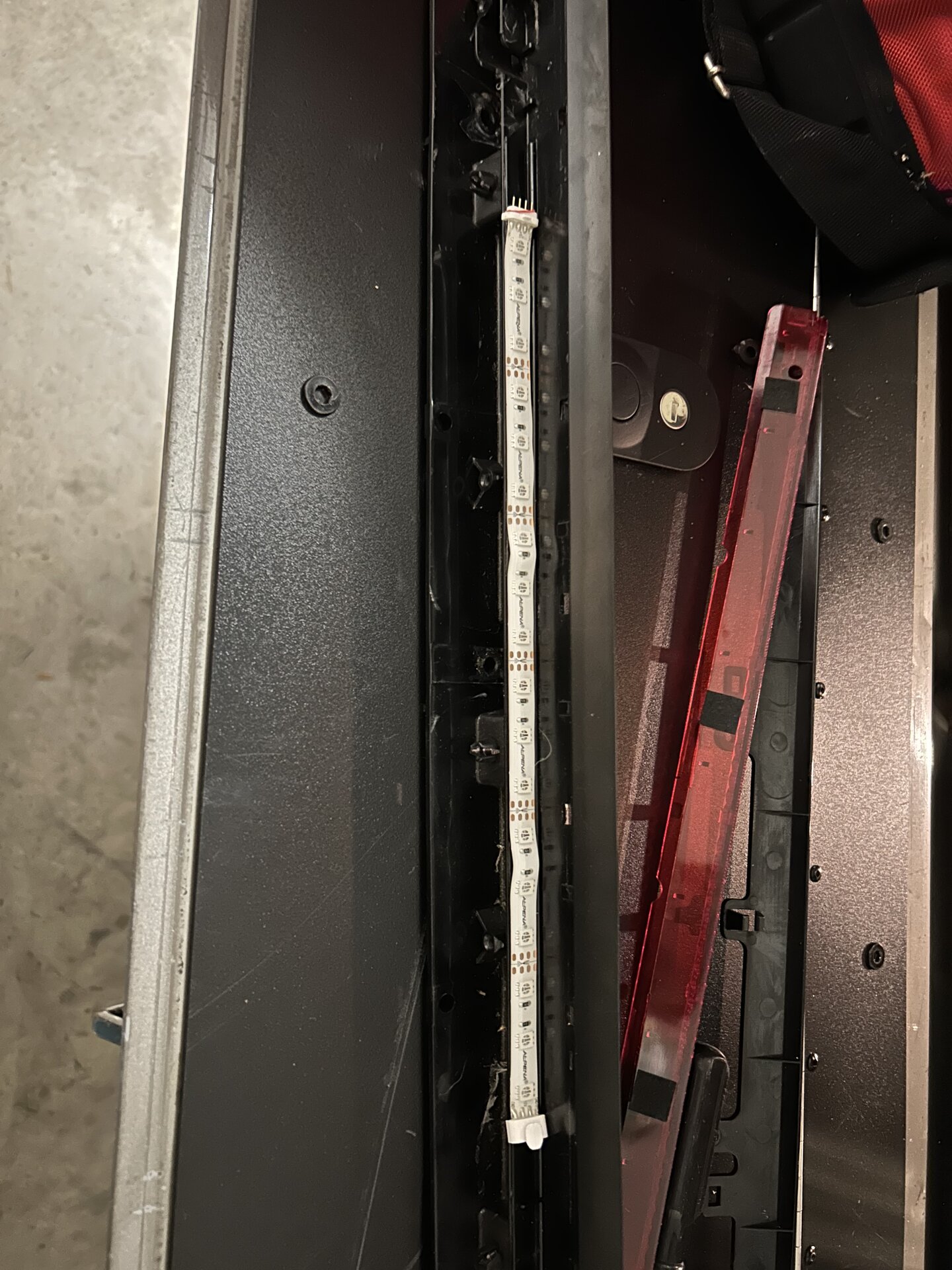

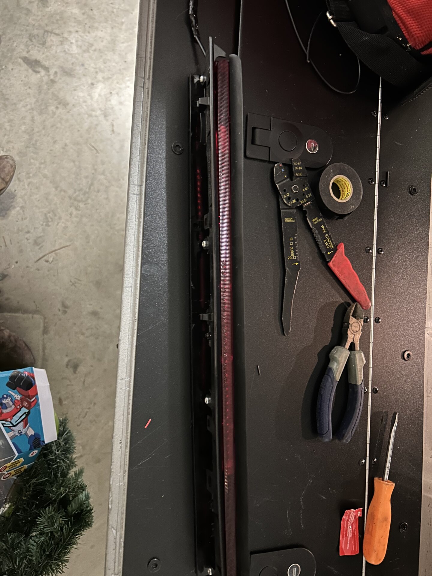

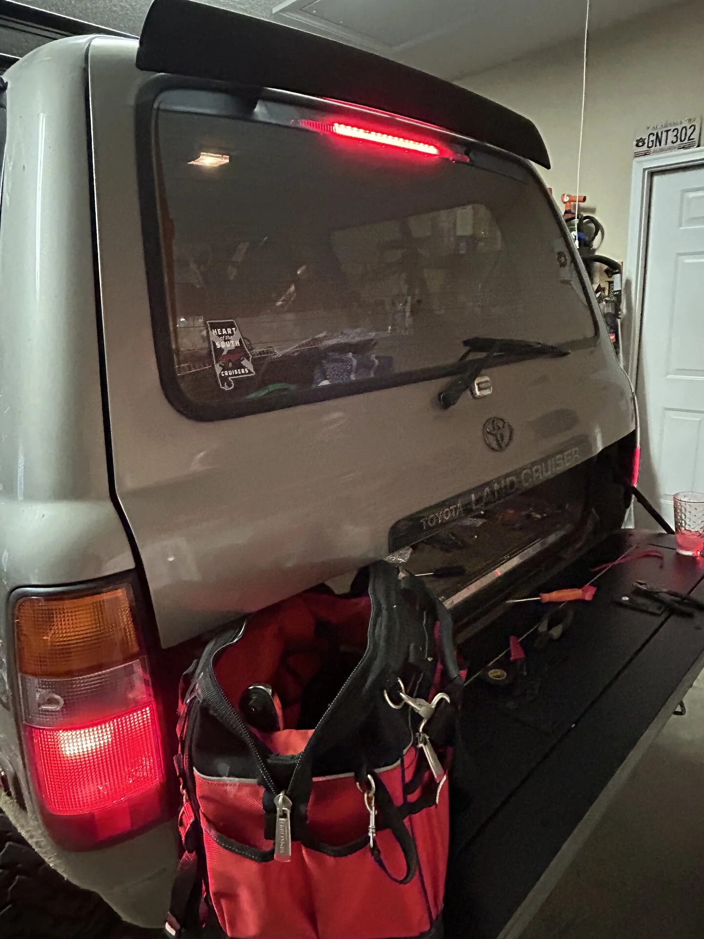

Installing dobinson rear bumper this week and many have said the spare blocks the pass taillight so this was a needed fix. I’ve seen some talk about replacing diodes to fix the third brake light. I tried and failed at that task so replaced with a red LED strip from Amazon.
Wired it into factory harness and used VHB tape to install it behind factory red lens so you can’t even tell it’s there.
