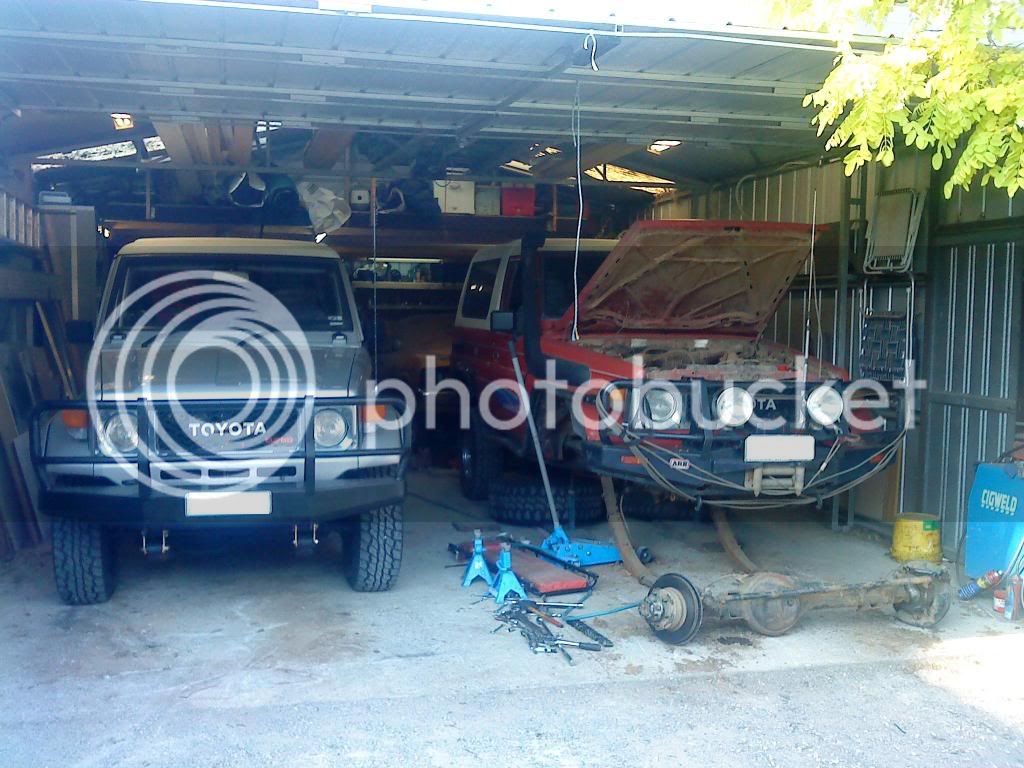

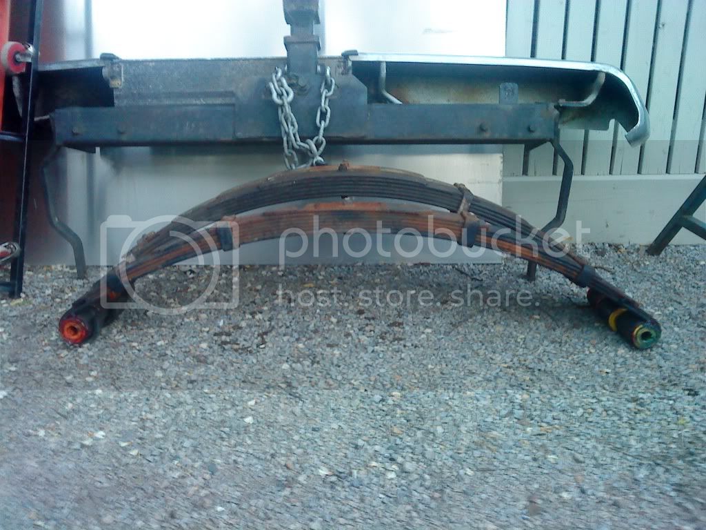

Swapping a few things between cars. And my 3-4'' lift springs behind my 2'' lift springs. I'm hoping the 3-4'' springs are abit sagged and leaves the front just lower than the rear.
Got the car registered on Friday morning, Fri arvo it went into the garage. Now it is twin locked, widened front diff, 60 rear diff, lifted suspension, boost controller, better drivers seat and 33'' muddies.
Unfortunately the 33'' rubber rubs hard on the front guards when flexed up and I dont know if a 1'' bodylift will be enough with my 35'' tyres. I dont really want to cut into the front guards as it looks so damn good!
I am really pleased with the front shackle angle and approach angle, with the 35''s on the approach angle should be really good. The diff is about 30mm forward at ride height.
Front shocks are maxed out, I need longer ones to take full advantage of the springs.
Rear is nearly at max droop but has more compression left. Setup is working well so far.
