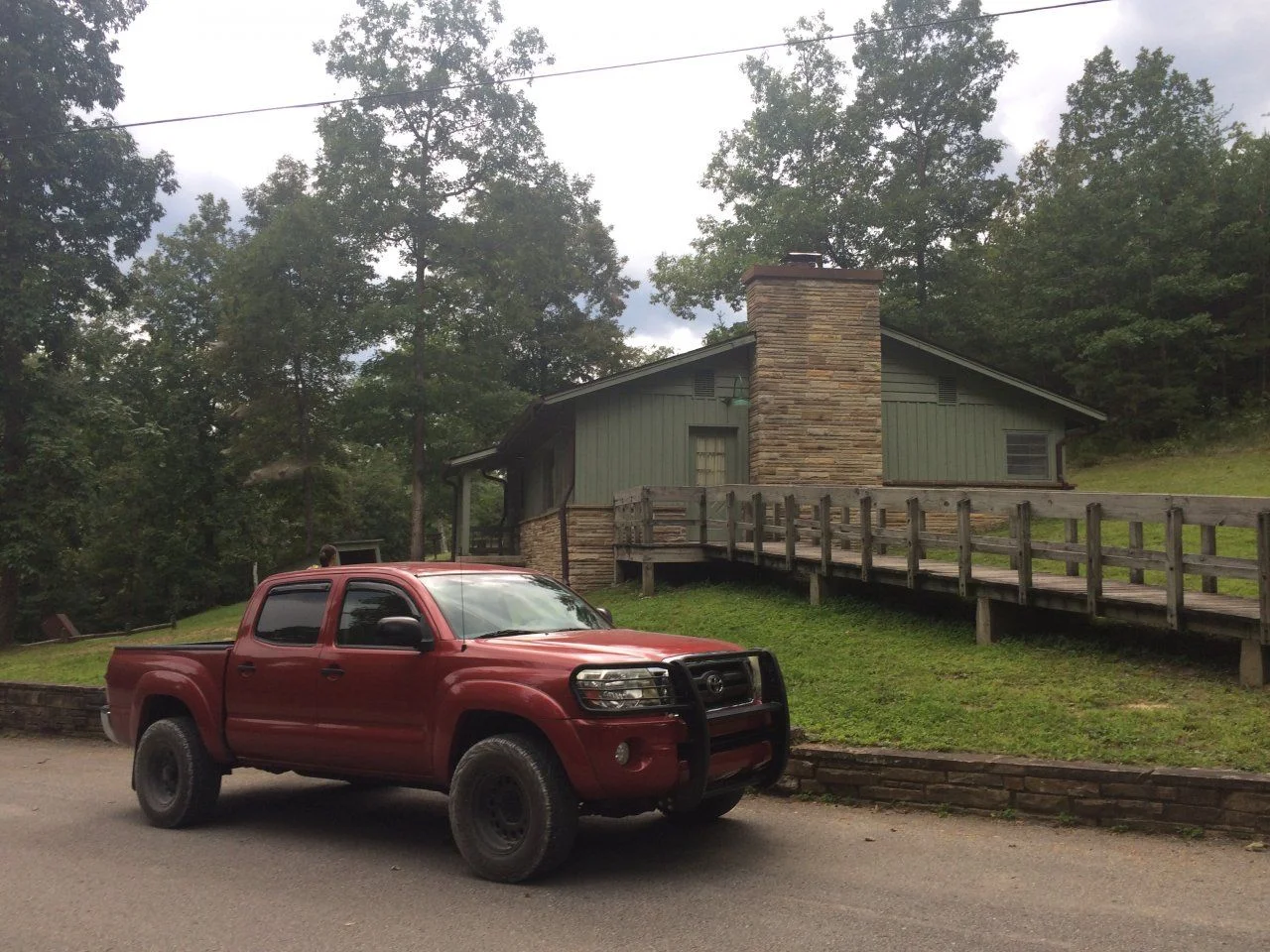

So here she is at Pickette State Park. Not a huge fan of the front brush guard but it doesn't look terrible and it came on the truck…

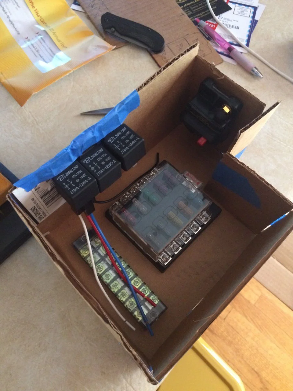

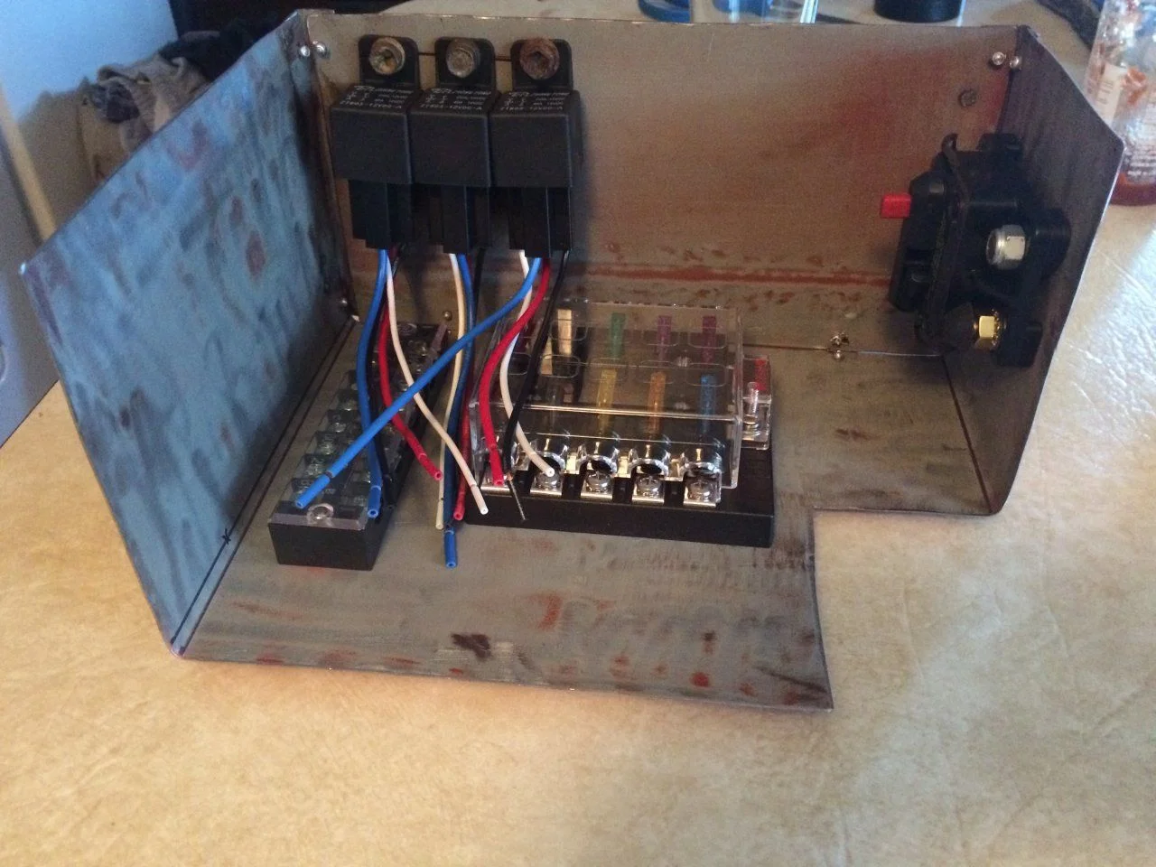

Here's the work on the wiring harness and relay box with fuses. SPOD's would have been nice but let's be real. I'm a cop and make peanuts so I can't afford that fancy crap. So I made my own. The relay's go to factory switches I found at the local Pick-a-part for $5 a pop.
The box is simple but effective. I do still need to make a cover for it just to keep dust and a majority of water out.
Here it is installed in the truck. At first I just ran constant power to it but very quickly realized that was not going to work. My wife kept leaving the heated seats on and killed the battery a few times. So I bought a 100 amp relay and installed it after the breaker and now have it triggered by the key.

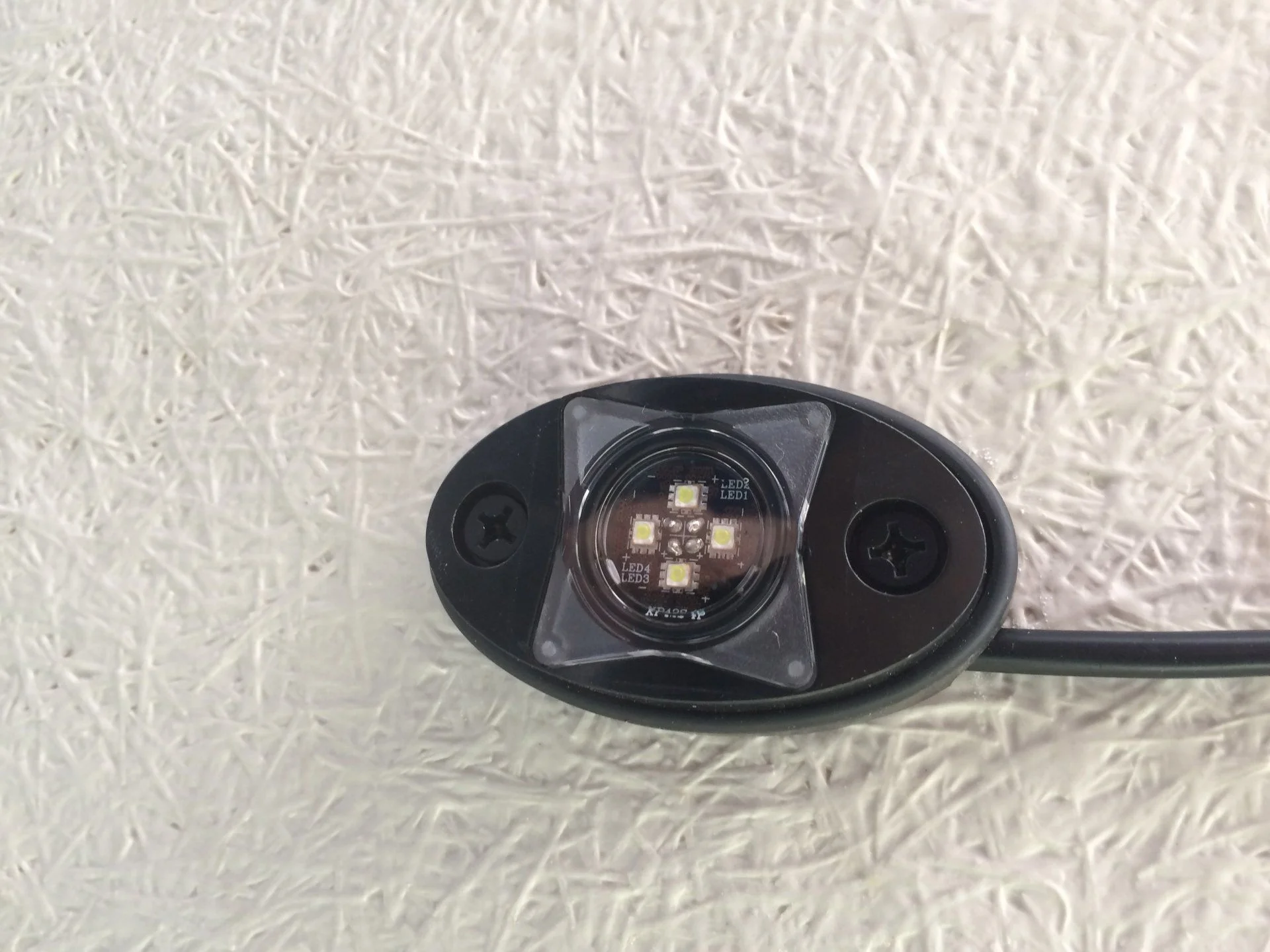

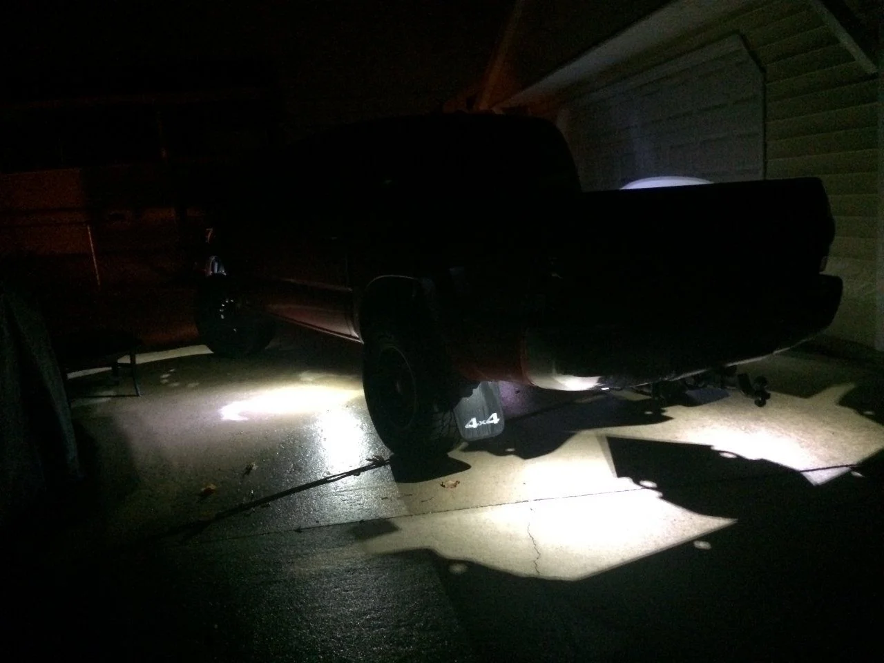

Rock Lights!! Upon investigation of the lights I found they only sent me 5 instead of 6. I emailed them and they immediately responded and another one is in the mail now. :cheers: I'll get some pics of those as soon as I get the last one installed. As of now I have 4 installed…. :hillbilly:
Looks good. Might want to reroute that primary power wire, less stress will prevent a future failure. And some split loom on some of that too.
True, ferg. I am planning on rerouting it. It's def not perfect but I had to start somewhere.
I got the last light in for the rock lights so today I'll be finishing up the install on those. The wiring is a little disorganized but it should clean up well. I do need to get some connectors so I can disassemble some the harness if I ever need to.

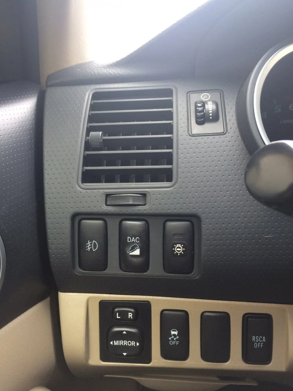

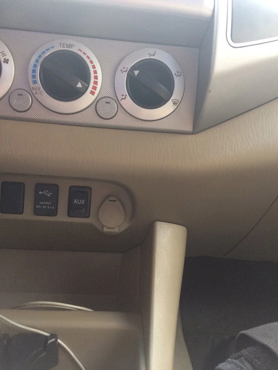

Here's what the dash looks like so far. The small lightbulb is the rock lights and the DAC will be relabeled as Aux Lights at some point. I found the switches at a local Pick-a-Part for $5 a pop out of a 4Runner.
The Dual USB Port is really nice so your not dependent on the cigarette lighter outlet to run all your USB accessories. It was about $15 on Amazon and fits perfectly.

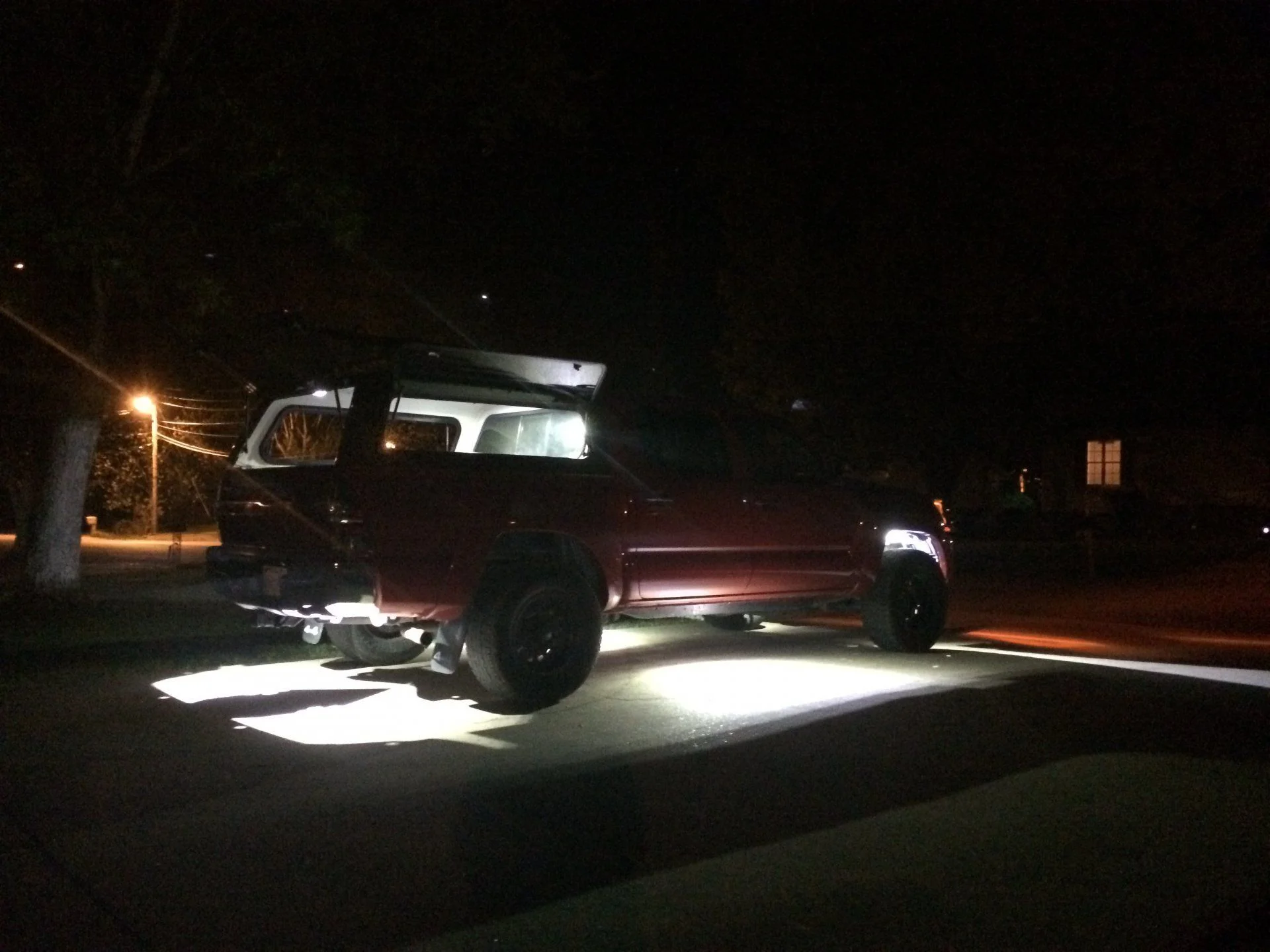

The rock lights are all done except for some tidying up of the wiring but they look great and are super bright.
So over the holidays the Red Devil definitely got a good workout. My wife and I traveled from Chattanooga, Tn to Cloudcroft, NM and back over the course of 11 days. We hit everything from mountains to dead flats, rain, sleet, and snow. The seat heaters worked flawlessly and were super nice. The rock lights were great for navigating some tight areas in the dark and for lighting the road for others as we crawled through a blizzard at 9500 ft. I even needed the flashlight at night while digging through all our gear. The USB port charger was used pretty much every time we got in the truck for one of our phones (and we have a headlamp that can charge off of a USB as well).

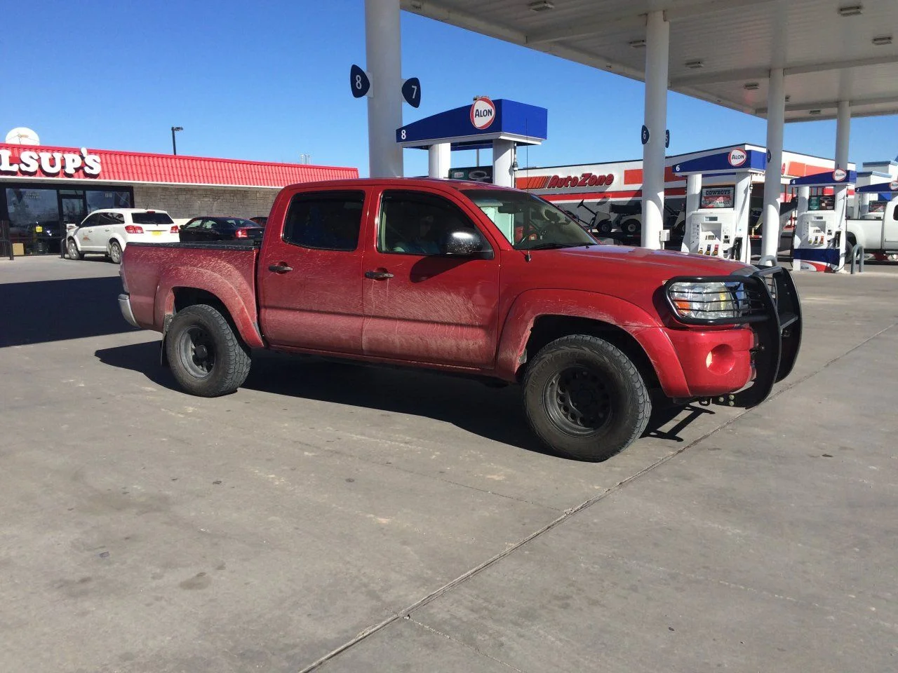

First Pic is just outside Roswell, NM

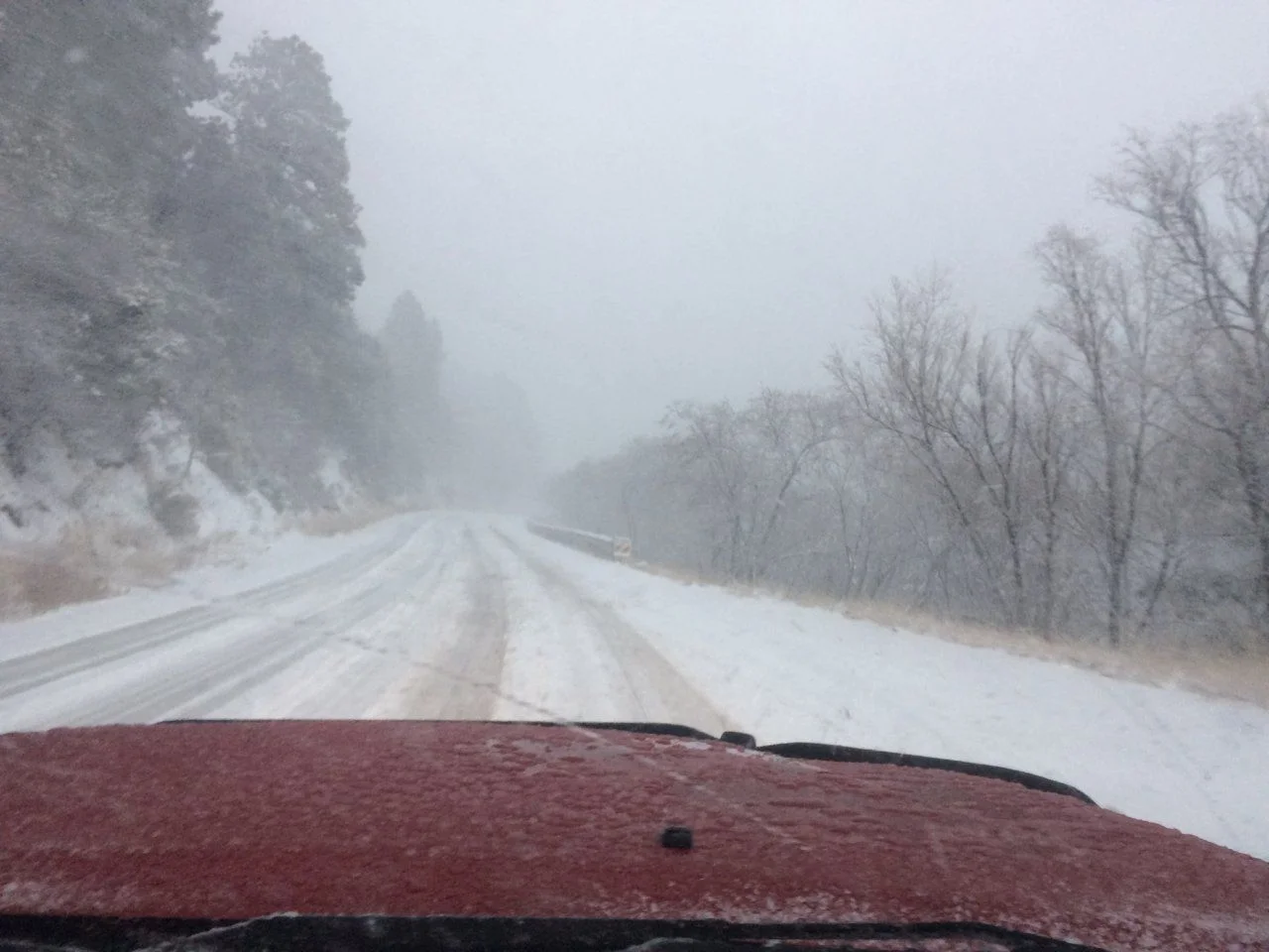

Second is a short trail we found just outside Cloudcroft, NM while it was snowing

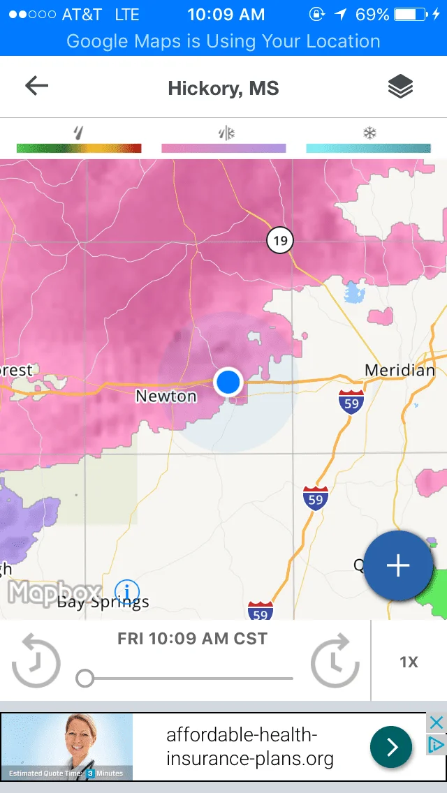

We stayed the night in a cabin in MS. We woke up the freezing rain falling. So we hit the road as quick as possible to try and out-run the weather front. It was pretty sketchy at times but slow and steady we kept going and were able to beat the worst of it.

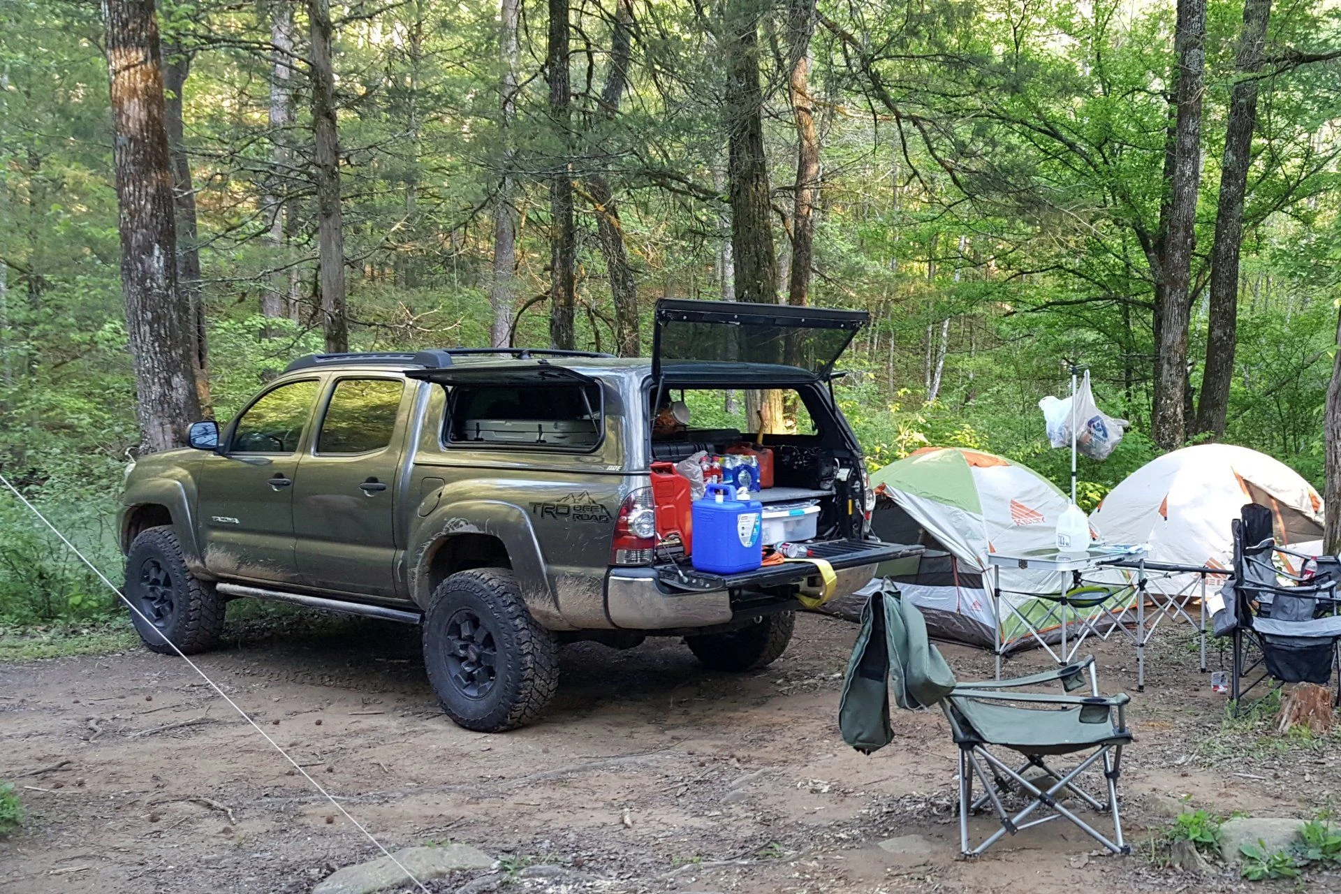

FINALLY WE FOUND A CAP!

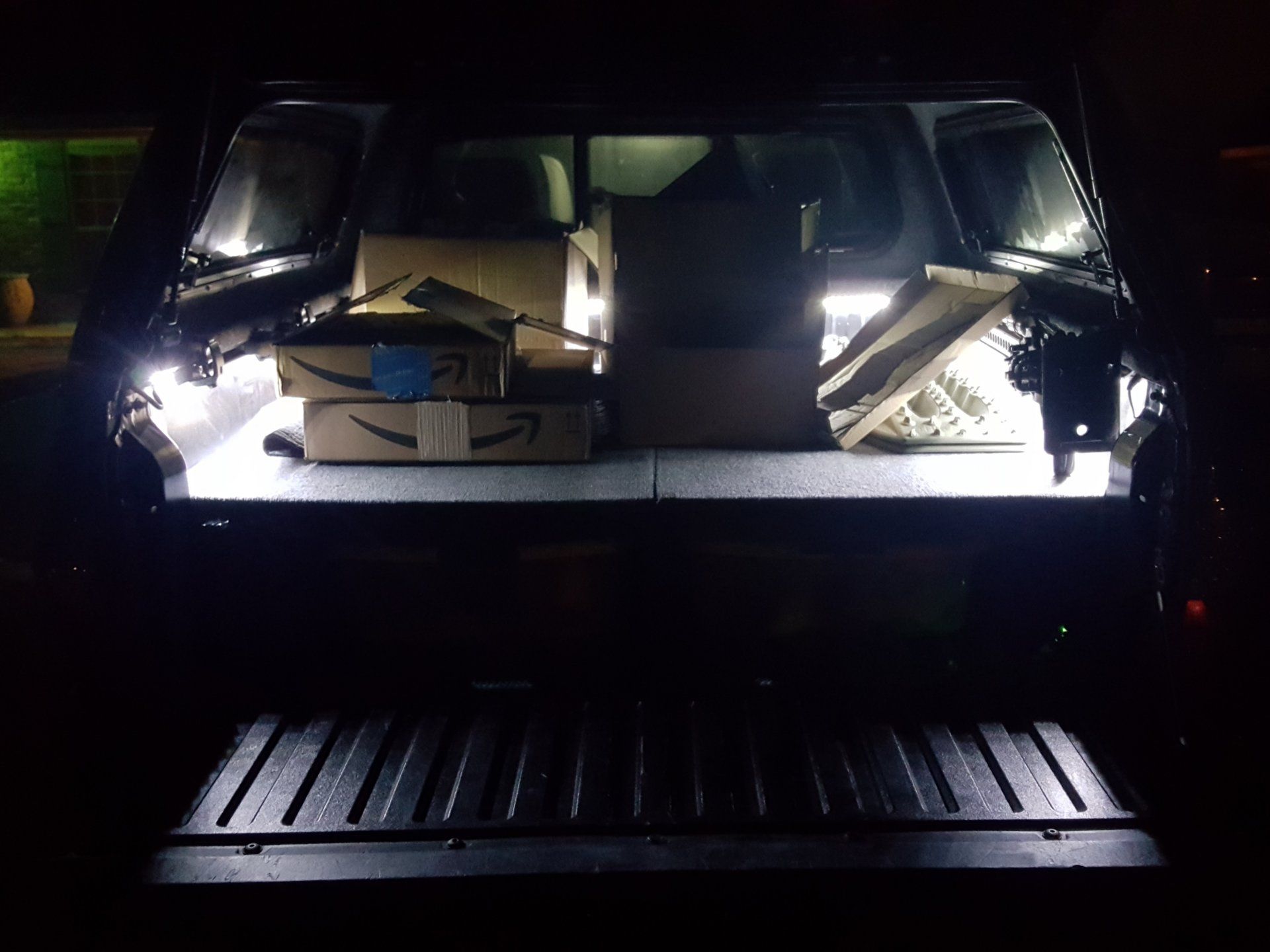

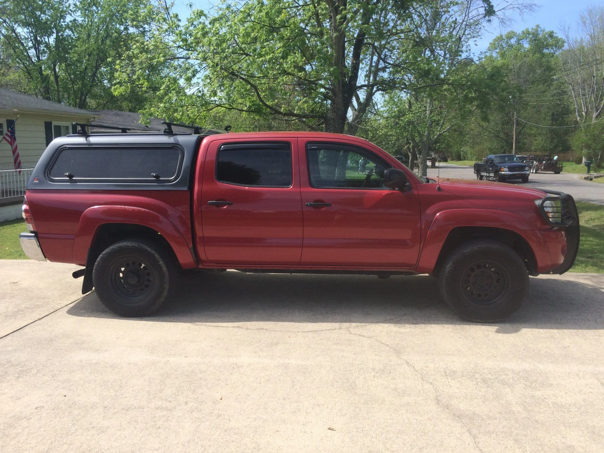

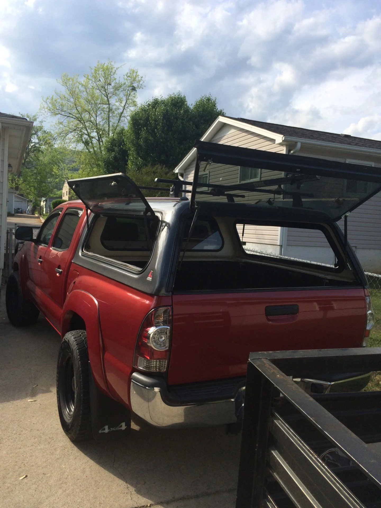

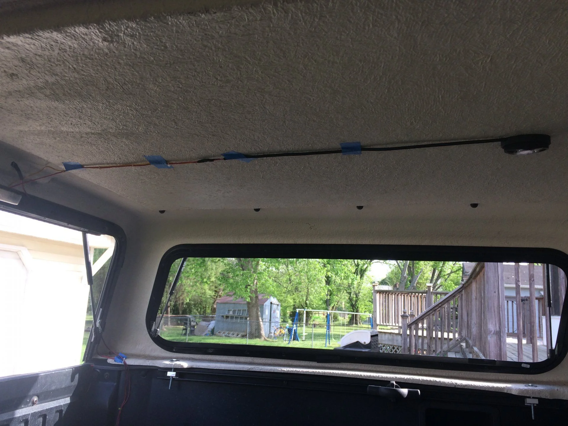

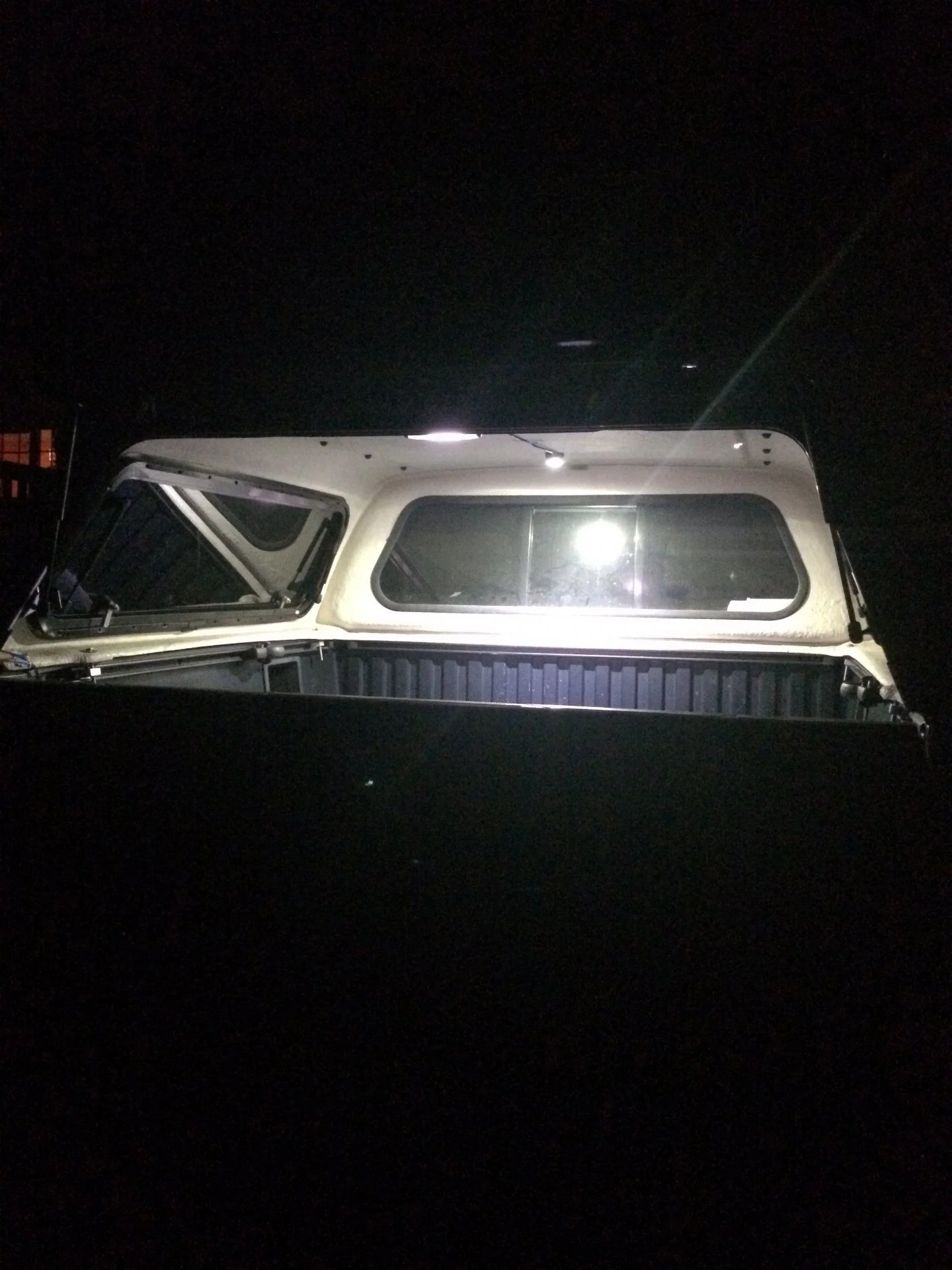

It's a Leer 100R/100RCC w/ a Thule roof rack and a Thule bike tray (Not pictured). It has hinged side windows, a third brake light, and an LED interior light. We found it on Craigslist down in ATl for $500! We are stoked!.

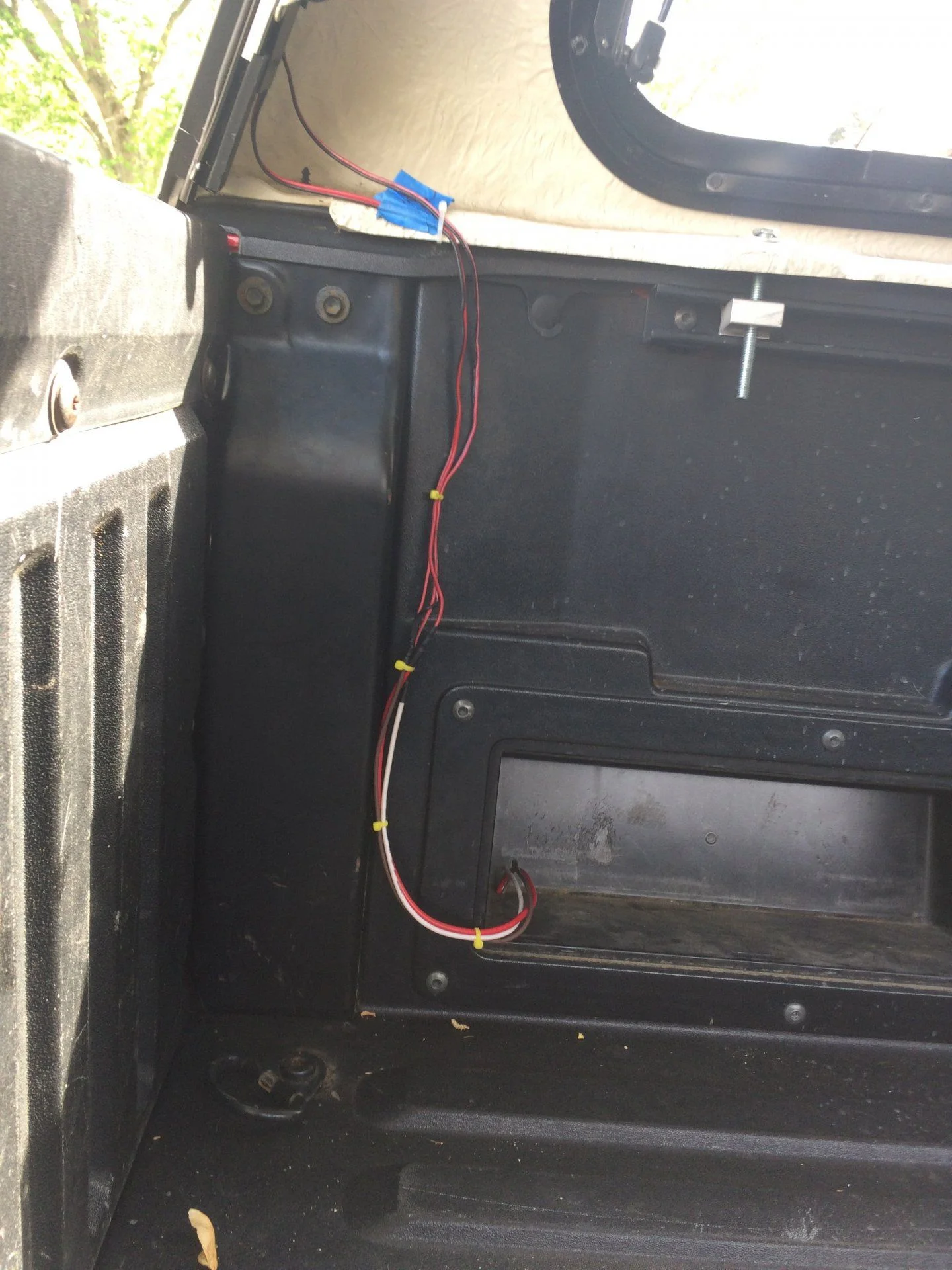

I wired in the lights yesterday and added a second interior LED light for better lighting. (I had an extra LED from the rock lights)
Don't worry I have some ideas on how to clean up this wiring so it's not a snag-hazard.

Nice additions for sure :cheers: I also have the ARE, CXT top with windoors on both sides its a great top. I went with the LED outdoor strip lights on the interior and have been very happy with them for the money and time spent. I added another strip right above the rear hatch which is not in the pic below. It has the remote to control for the brightness which is nice. We did a week trip in the Ozarks last month and they worked out great seeing in the back to get our gear. I also swapped out all the interior bulbs for LED which made a big improvement. The black TRD wheels have a cleaner look IMO and they're easy to touch up after any rock rash
Thanks Volunteer!
Yeah the side windows are fantastic for accessibility.
