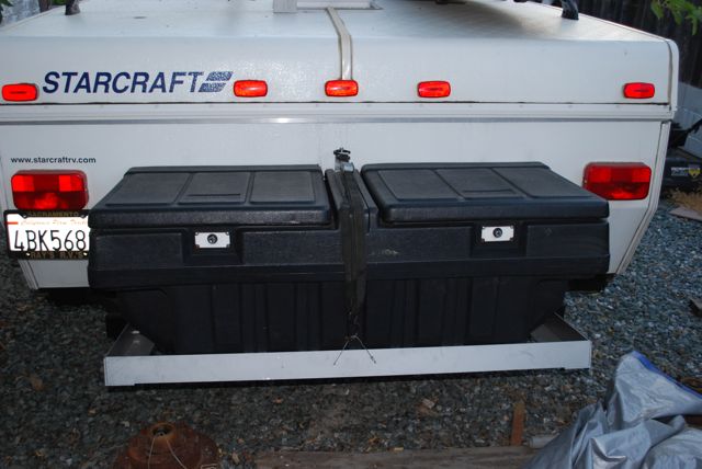

Ok , here is some of my junk... On a starcraft mo # 17 something
1-2. rear rack and built up bumper
3. Yak rack w/ box & bike racks
And more

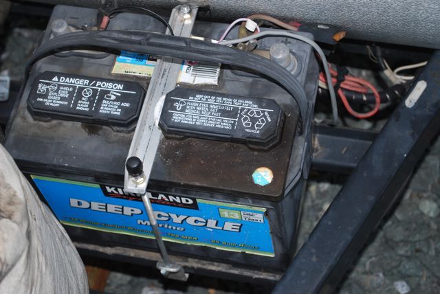

1. custom battery hold down.
2. Welded on some jacks from a honda (junkyard)
3. re located spare.
Have some other crap inside , I will update when I open it up again.

WOW..the jacks were a brainstorm..now I'm booting myself in the ass I didn't go down the street and do the same. How far down do they go? Great mods, mod that baby to death!
You come up with some of the coolest ideas Ken. The jacks are great, I imagine way cheaper than the same thing from an RV store. One suggestion, replace the funky jack handle attach point with a 1/2" nut. That way you can use a cordless drill to raise/lower the jacks.
