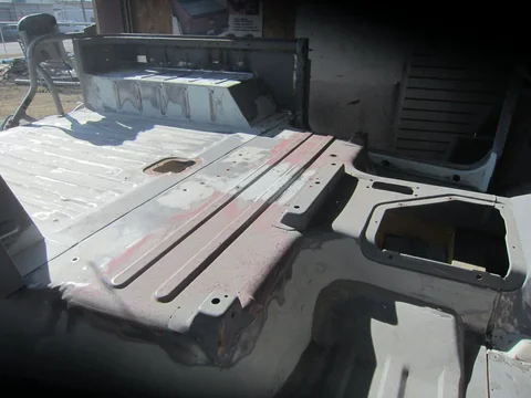

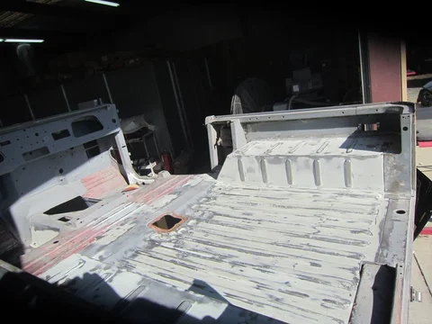

Working on inside of tub. From the seats forward is ready as the floor pans are molded in. A little progress on the rear bed. Baby steps, but any progress is better than no progress.

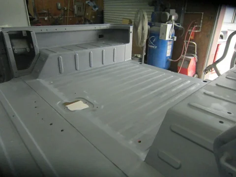

Rear bed & fender wells ready for primer, finally. (I did call this the Long, Slow Build)

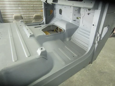

A little work on the outside is next. It will need some attention where the new rear quarters are molded in, and the DS outer rocker needs a little work. Cowl is in really good shape, just some minor issues to deal with. And a few small things to address - location of rear emblems and the rear reflectors, spare tire carrier adjustment, etc. Anyway, here are a few pics of the progress.
Also, worked on the vertical lines where the rear quarters transition to the rear seal below the doors. And made some adjustments to the rear tire carrier and welded the nuts in place for that.
