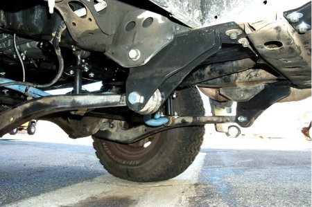

As I'm sitting in my drive way tonight finishing up my axle swap, I was wondering why don't you do the washer mod to the back side of the control arms to correct caster?
If you lowered the rear of the control arms a little, wouldn't that be the same? Or am I liking at it wrong, or is there too much stress back there?
You mean... Like "4+" brackets?
Keep in mind: them bars is leveraged like a catapult. So any slight movement at the axle is a drastic movement the farther out you go... so it would be more than a washer move.
Yeah I guess I do. I had never seen those.
They didn't take off very well.... No one wants a lift with drop brackets. We ain't no Ford or Cheby club!
It looks like due to the geometry you have to go down a long way.
you have to go down exactly as much as you lifted the truck.
Man-a-fre pairs them with CC bushings for bigger lifts. The problem there is that you have now created an unpredictable angle with the front pinion.
I don't know, I think they have sold a bunch of them. You see a lot of trucks with them installed in the 80 section. There was a video of a truck rock crawling over some huge boulders with them posted a couple of weeks ago, he didn't seem to have any problems with them.
I can see the appeal for a mostly street driven truck, it keeps the front end geometry, ie arm angle, factory. It also keeps the front tire from moving backwards into the fender like plates do.
I bought a used set from a guy that said they hung up too much
I never installed them after I got hung up on my factory mounts that first time with ACC.

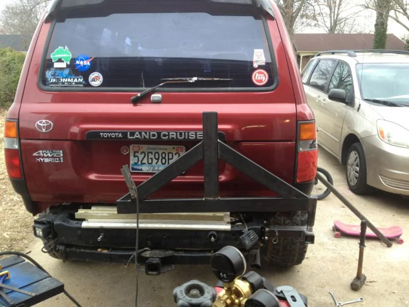

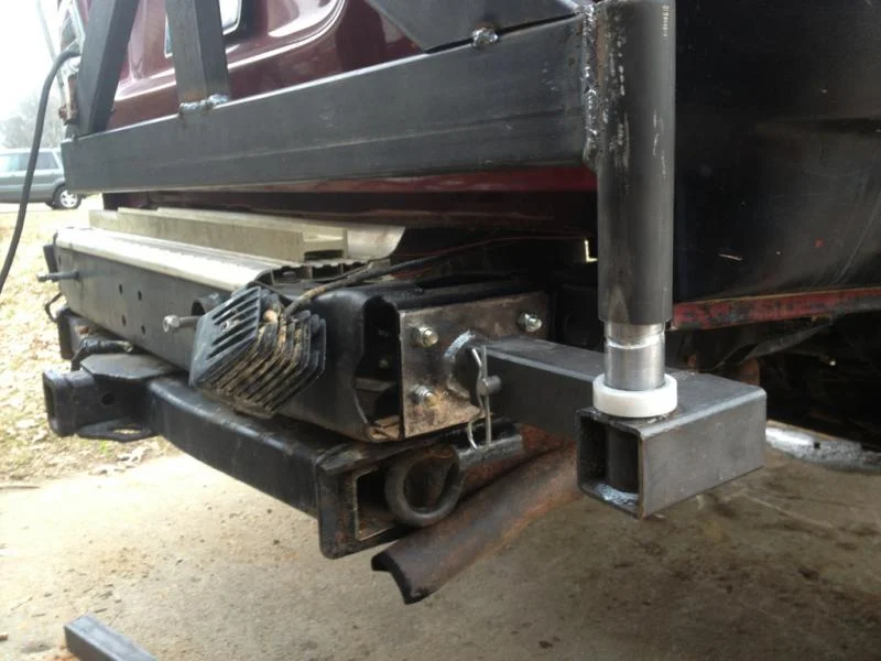

I had a stomach bug hit the entire family today including me, so I couldn't go to work today. I did however get to work on the cruiser since its a lot closer to el bano. I had put together a cad drawing for a tire swing out a couple of weeks ago that bolts to the stock bumper and I got to put it into motion today. Ill do a full right up when it's done but here are the "getting close to finished pics.
